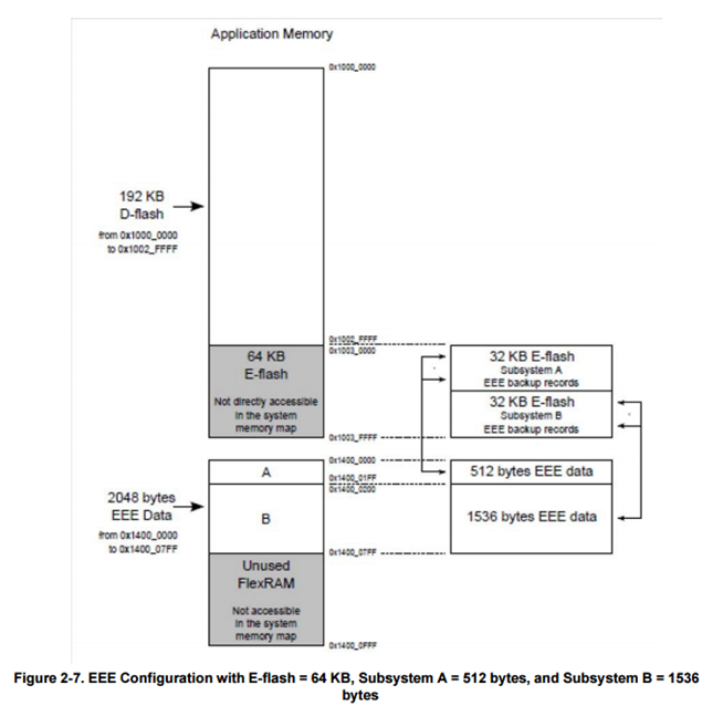

Now for the actual question. Looking at the FlexNVM EEPROM application note AN4282, figure 2-7 it looks like the two subsystem EEPROM backups partitions live on the same block at adjacent addresses. On page 14, section 3.3 it actually states this in words "the EEE space is allocated starting at the beginning of the FlexRAM... up to programmed EEE size".

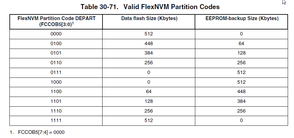

The Table 30-71 in K60P144M150SF3RM Rev. 3 of the Reference Manual is wrong and should be:

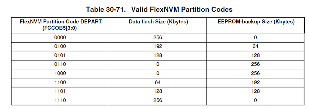

The Documentation people know of this (now) and if you happen to have the older Rev. 2 it was correct.

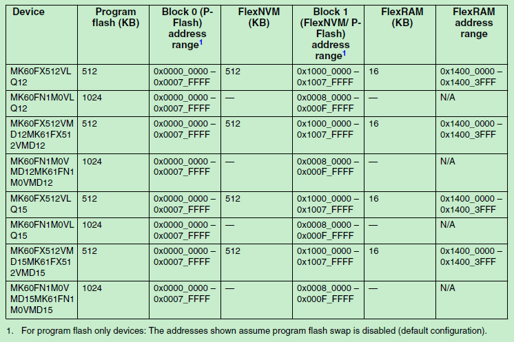

Please check below picture about K60FX512 device FlexNVM address range:
The K60FX512 device FlexNVM size is 512KB, when customer using FlexNVM split to EEE backup memory and data flash left memory.
The Data Flash start address does not change, still be 0x1000_0000, while the size is based on FlexNVM partition code.
For example if FlexNVM partition code set EEE backup memory is 256KB, the Data Flash start address at 0x1000_0000
Data flash memory range from 0x1000_0000 to 0x1003_FFFF (256KB).
Wish it helps.
Ma Hui

I look at table 30-71 in K60P144M150SF3RM.pdf, Rev. 3, November 2014. The numbers there do not add to 512K. Why? I tried to address this in K60 FlexNVM Set Partition but got no concrete answer so far. Note that in an older version of that reference manual, the numbers did add up to 512K, see the linked forum thread. Maybe the EEE backup allocation is per 256K block? Nothing explicitly states that. PEx follows the behavior of the old table posted by kerryzhou​ in K60 FlexNVM Set Partition .

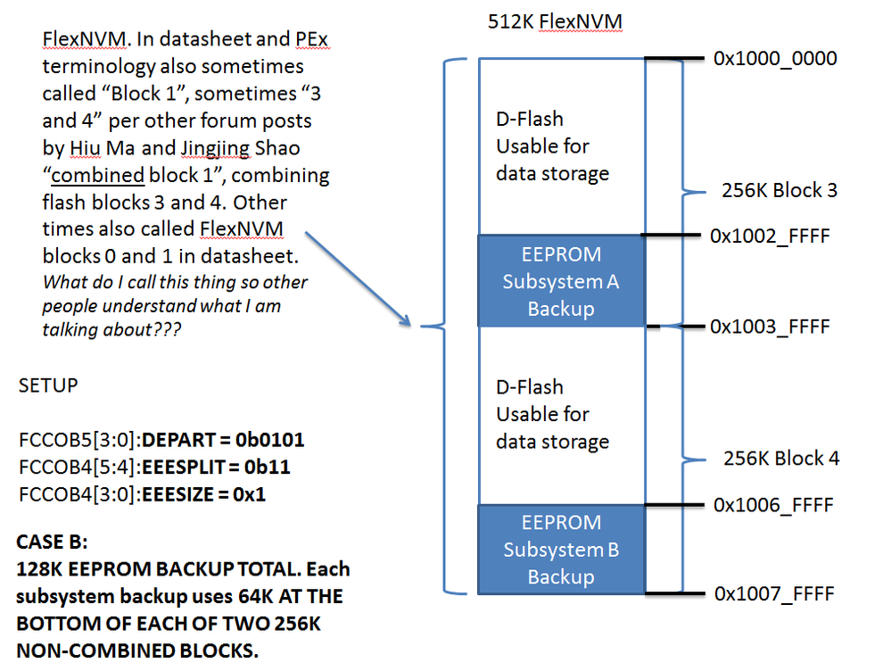

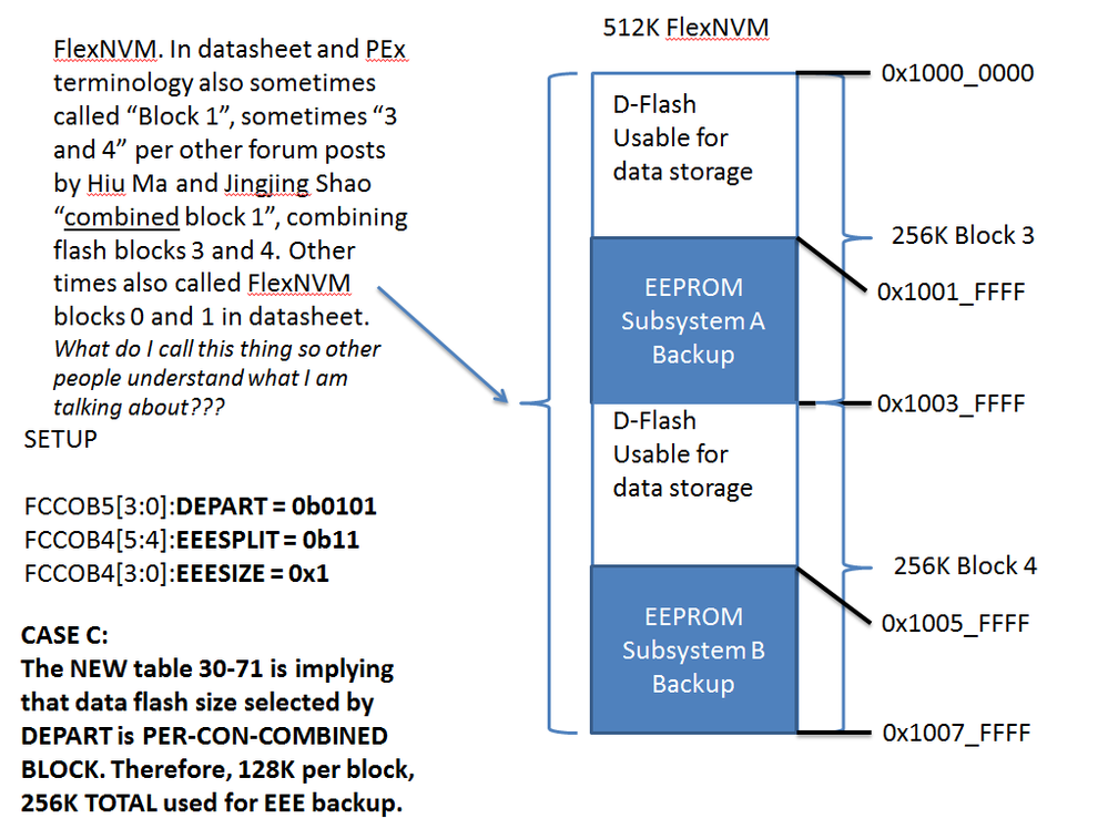

Great. I now have 4096K of EEPROM. But which specific addresses are still available as D-flash? Given the documentation I've seen so far, there are three possible cases, as illustrated in the following figures. Which is it? CASE A? CASE B? Or CASE C? Or something else?

Thank you, that makes sense. I think that's case A on my diagram, and happens to be the most straightforward and intuitive thing to do.

I got the confirmation, the old version reference manual with the correct FlexNVM partition codes.
