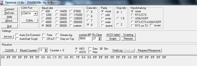

Image from UART Terminal:

EarlOrlando
Senior Contributor II
Helo Wojciech,
Are you always receiving the same values after reset or these depend on the accelerometer position?
Earl.
3,888 Views
wojciech22a
Yes. After the reset, the first portion of the data are always the same regardless of the position of the accelerometer during the reset.rysun2.PNG
Many times I reset the KL25Z in different positions -. but always values that were sent by the UART, were the same
3,888 Views
EarlOrlando
Hi Wojciech,
You need to activate the accelerometer by writing in the register 0x2A CTRL_REG1 register in the bit field 0 after configure the accelerometer (resolution, etc).
Earl Orlando.

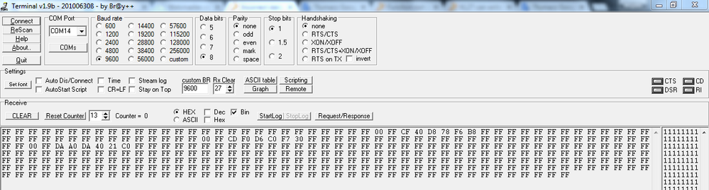

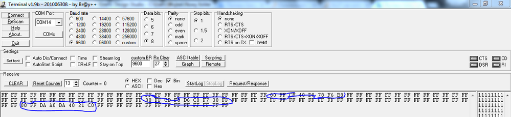

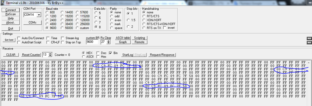

wojciech22a
Mark, Earl - thank for your help!
The first value which is being sending after reset, in my new program is being depending on the position of accelerometer during the reset. When the accelerometer is at different positions at the time of reset,  I receive the data with different values. Unfortunately but in every subsequent sequence of bytes, I receive incorrect data.
Program (main):
