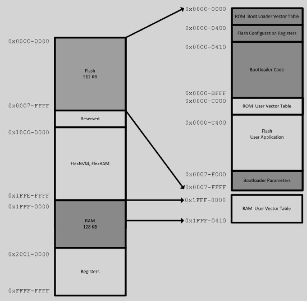

Great Ap Note... Coded into two designs... works like a champ!
So here's my stupid question:  How come this works????
This approach to bootload involves executing and programing Flash memory in the K60 all confined to Block 0. How is it that I am not seeing read while write issues???
See this from AN4367 (note, the application itself is loaded into 0x0000_C0000):
The bootloader is placed into the first 48 KB of the on-chip flash memory, but the actual size of the bootloader can be smaller. The user application can be placed into the flash area above the bootloader flash area. The last 4 KB of the flash memory must be reserved for the bootloader's parameters storage, which is defined by the size of the erase-page of the on- chip flash memory.
The following figure shows the memory map and the bootloader memory footprint. The bootloader code is located in the first address of the flash memory, 0x0000_0000 to 0x0000_BFFF. The bootloader parameters are located in the first address of the last logical-block of the flash memory, 0x0007_F000 to 0x0008_0000 (in Kinetis MK60n512).

This is possible because there is a small piece of code executed out of RAM.
/* == Should be in the RAM ==*/
#if FNET_CFG_COMP_CW
    #pragma define_section FNET_RAM ".FNET_RAM" ".FNET_RAM" ".FNET_RAM" far_abs RX
  __declspec(FNET_RAM)
#endif
#if FNET_CFG_COMP_IAR
    __ramfunc
#endif
static
#if FNET_CFG_COMP_UV
    __attribute__((section("FNET_RAM"))) __attribute__((used))
#endif
void fnet_ftfl_command_lunch_inram(void)
    FNET_MK_FTFL_FSTAT = FNET_MK_FTFL_FSTAT_CCIF_MASK;
    while (!(FNET_MK_FTFL_FSTAT & FNET_MK_FTFL_FSTAT_CCIF_MASK))
It is not executing from block 0 while flashing the block.

Thank you Alejandro -
The odd thing is: one of my designs I definitely do not jump to RAM (FNET was doing this for me on the other as you pointed out).  The only guess I have is that maybe the instruction cache prevented the error?  At any rate it has been redesigned to use page 1.  Thank you for your reply.
