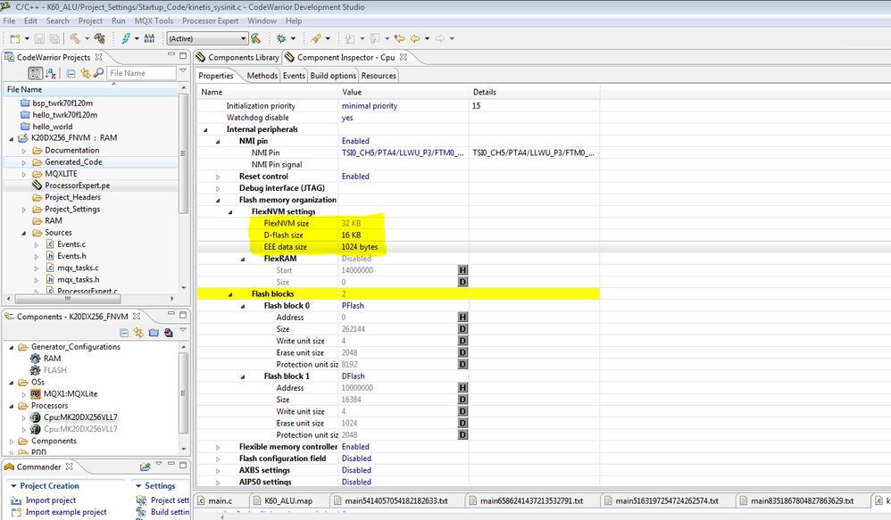

Is it possible to use the FlexNVM features through MQX-Lite?
If so, are there built in settings somewhere?
I am using a K20DX256VLK7
Thanks in advance.
Tim
1,169 Views
alejandrolozan1
You can try to create a EEEPROM partition using the MCU component. Please see the below picture:
I hope this helps,
