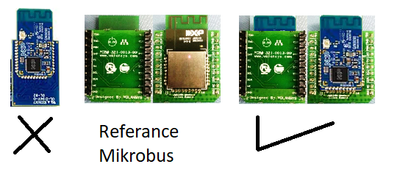

I see that design files are available for OM15069-K32W for K32W module. But while searching on the internet I came to know that it is not available on NXP or other websites.
Only for OM15080-K32W based modules with expansion board available.
Is there any chance that we got the raw module without the nxp expansion carrier board for OM15069-K32W type?

yagnikpokal
K32W module (K32W-001-T10) Is comes with a module + expansion board.
We need to create our own expansion board as we want to put this on a standard mikrobus connector. So K32W-001-T10 will not fit.
Hence, is there any possibility that we get K32W without an expansion board?

Ricardo_Zamora
As you know, the module is part of our development kit, and therefore only the "complete" upgrade module (K32W-001-T10) is sold, to work with our DK6 carrier board.
You can take the Designs Files as a reference to make your own module.
