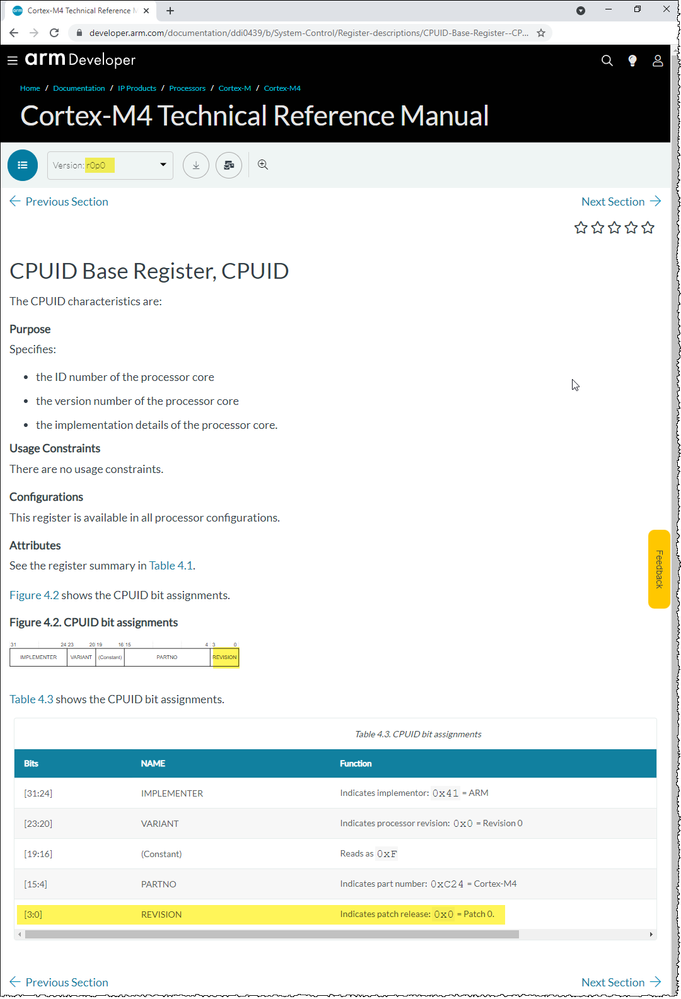

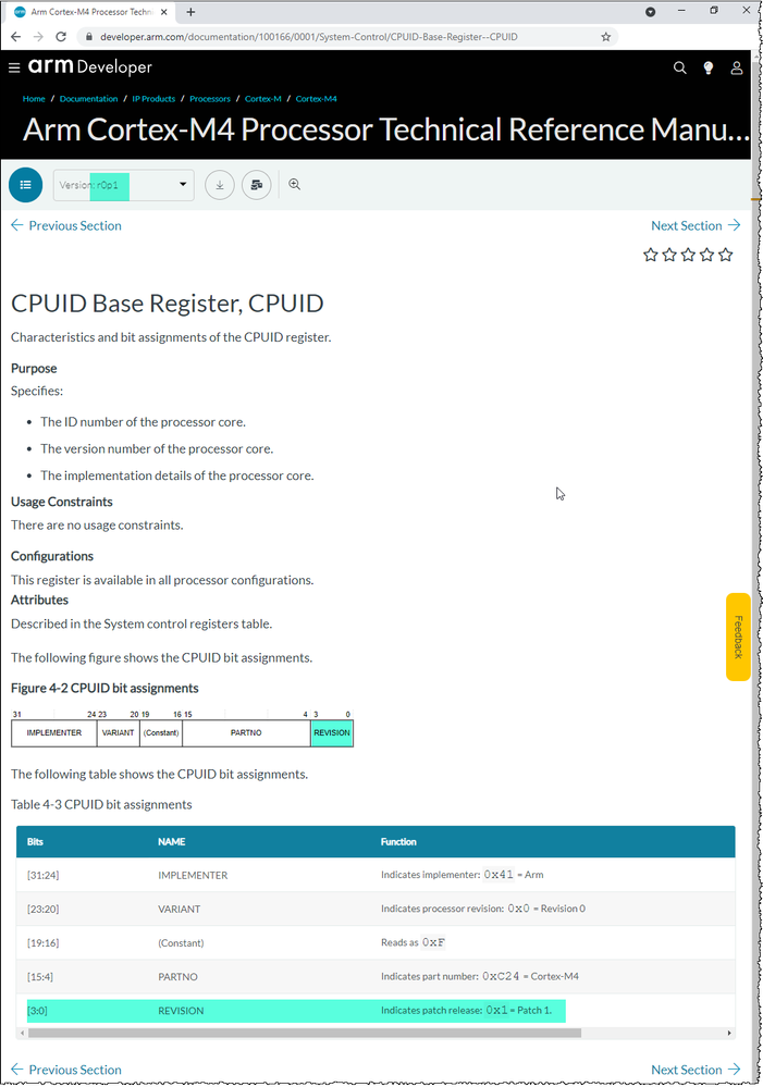

Hi nico547845,
CPUID Base Register
[3:0] Revision Revision number, the p value in the rnpn product revision identifier:
0x0 = Patch 0
0x1 = Patch 1

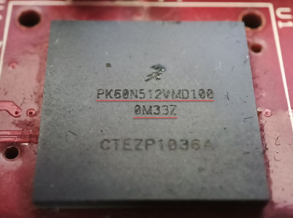

Would you please show the photo of these two MCUs? Check the part number(first line) and mask set(second line), there may some different between these two MCUs.

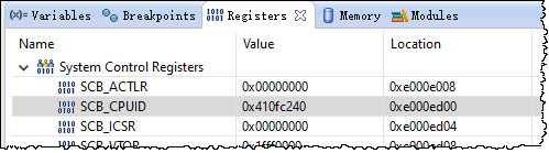

This is the photo of MCU on TWR-K60N512 during debug I can see the CPUID=0x410FC240

Hi Robin
The chips I have problems with are
MK60DN256ZVLL10
4N30D
The ones that work
MK60DN256VLL10
5N22D
3,283 Views
Robin_Shen
AN4445 Kinetis 100 MHz Rev 1.x to Rev 2.x Migration Guide will show you the difference between MK60DN256VLL10 and MK60DN256ZVLL10. The program developed for MK60DN256VLL10 cannot be run directly on MK60DN256ZVLL10 without modification.
