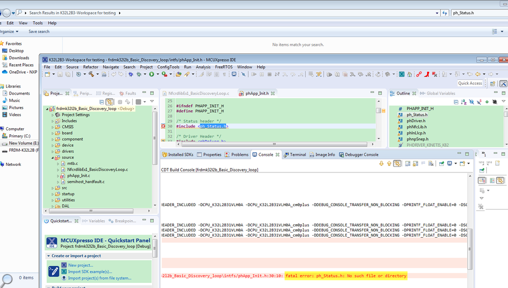

  Project lack ph_status.h files:
If you test the SDK project directly and without the OSC issues, then the problem still related to the NFC code porting.
Please provide the lacked source file. Or you can test it on your side, without build issues, then give me again.

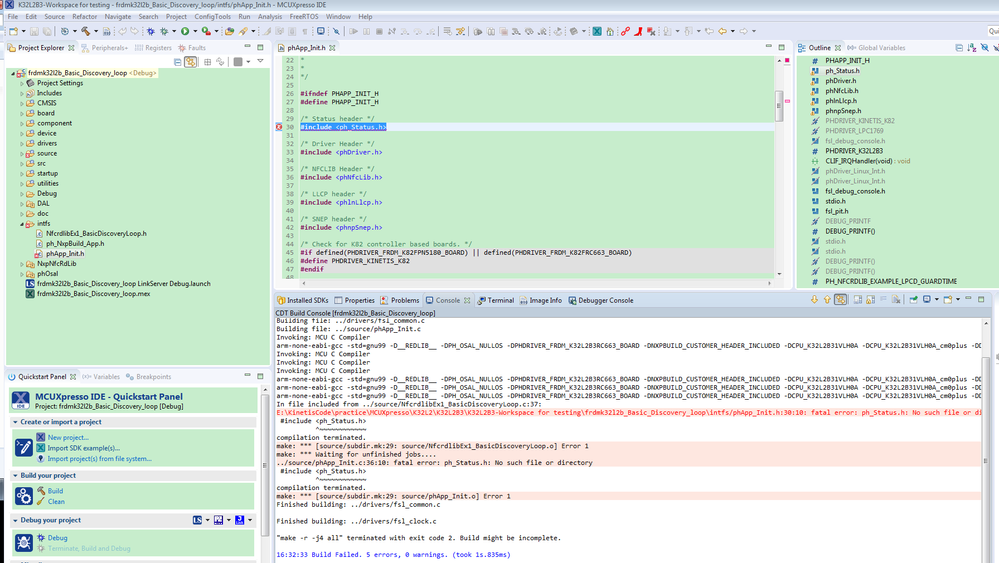

nxf60094
Hey Kerry,
Sorry, I corrected the code and have uploaded the revised version. Now could you please check.
I checked the hello world demo example and it was working. If you have any documentation for NFC reader Lib porting apart from the ones available online could you please share it. Thanks.

kerryzhou
Hi Yadhnyaseni Kayande,
     Do you update your project in the first post?
    I download it again, but still the same result:
   Please double-check it again, I still didn't find your ph_status.h.

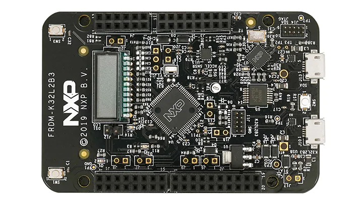

  Do you use the FRDM-K32L2B3 board to test your project?

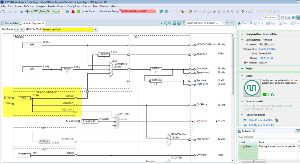

  I checked your project, why you use 32Mhz OSC.
You can check the SDK hello world project, it is using the internal 48Mhz

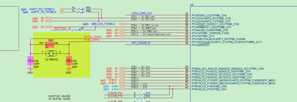

You can check the FRDM-K32L2B3 schematic, the EXTAL0 is 32Khz OSC:
This is the root reason why you stop at the OSC.
