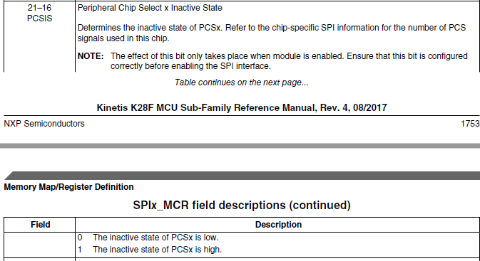

Your problem could be caused by a wrong configuration of the module.
PCSIS field in MCR register determinates the inactive state of chip select signal.
In SDK example the follow instruction:
masterConfig.pcsActiveHighOrLow = kDSPI_PcsActiveLow
Ensures PCSIS equals 1 in PCS0 bit field in order to pull down chip select signal when the transmission starts.

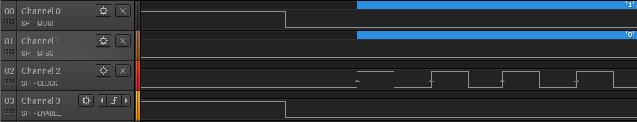

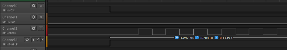

Next pictures were taking when PCSIS[PCS0] value was zero and one respectively:
Is your K27 presenting a similar behavior of the first picture?
