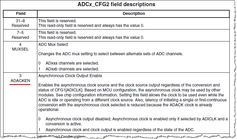

If you select Asynchronous clock (ADACK) as clock source, you may need to disable it by clear ADCx_CFG2[ADACKEN].
ADC0->CFG2 &= ~ADC_CFG2_ADACKEN_MASK;

jonathanhuber
Hi Robin
I have tried this config but the current is about 70 uA.

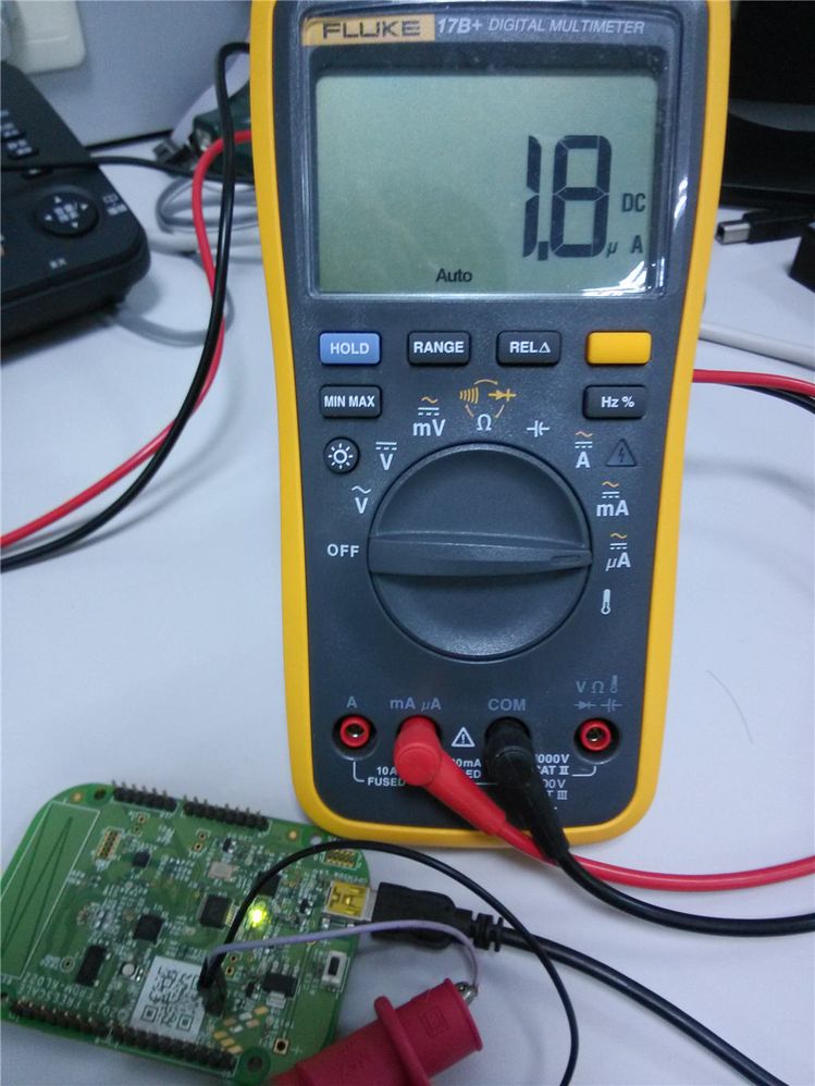

Robin_Shen
I have modify the adc16_low_power in SDK_2.3.1_MKL02Z32xxx4 and get the result on FRDM-KL02Z(RevB).

jonathanhuber
Hi Robin,
Thank you for the modified example.
The Problem was that the highspeed mode was enabled. is it right that the highspeed mode in vlps mode is not recommended?
