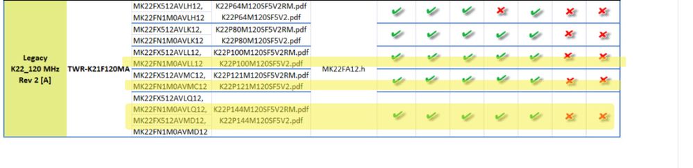

   In fact, the MCUXpresso IDE wizard can select the USB, the perpherals, it is based on the SDK2.7.0 package. But MK22FN1M0AVMD12's related SDK is the SDK2.3.1, which is not in the support list now.
   I have help you check with the SDK related department, they told me, the new SDK2.8.0 which will launch in the near future is also not update the MK22FN1M0AVMD12 SDK(TWR-K21 sdk), just the FRDM-K22 is updated.
   So, maybe you can't use the MCUXPresso IDE new feature for your chip MK22FN1M0AVMD12  now.
   About your question: Can the part that I'm using (the MK22FN1M0AVMD12) be updated to SDK 2.7.x?  I'm not sure why you would ask about the K21 series.
  If you check the doc which I recommend you:Kinetis K22_120 MHz devices
 You will find MK22FN1M0AVMD12 is using the K21 platform SDK, the clock system, the module is the same IP as the K21, not FRDM-K22,  K22 have a lot of series, different partnumber need to refer to different board, that's why I double check it with you.
  I have a question, could you please also provide the detail MCU requirement, I want to check, whether some other new updated SDK MCU can meet your demand. What about K24, K28, K64, K66, whether these partnumber can meet your demand, these chip are also have FRDM board and update the SDK now.
From the now situation, seems the K21 SDK(also for MK22FN1M0AVMD12  ) won't update anymore. It's also difficult for you to generate the new package which also let the MCUXPresso IDE tool to recoginize it for your requirement module configuration.

   If yes, you can't refer to the FRDM-K22 board, you need to refer to the TWR-K21F120M board, as K22 series have a lot of types, you can find some information from this link:
https://community.nxp.com/docs/DOC-102548
About the TWR-K21F120M new SDK, I will help you to report your requirement to our SDK team.

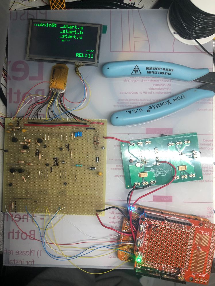

Here is one of the prototype circuits that I'm using for the product development:
