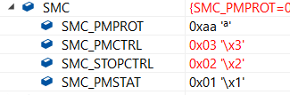

In debug, the SMC_SetPowerModeLls() function is returning success, and when I read the SMC->PMCTRL register it's set to 0x3, which according to the user manual is low leakage stop mode.
The power mode permissions are being set correctly to allow all power modes, which I confirmed by reading the SMC->PMPROT register, and anyways the stop abort flag in PMCTRL isn't being set when I try to enter stop mode.
And yet, after I step over SMC_SetPowerModeLls(), execution doesn't halt - I can immediately step the the next function, and the next.  The debug connection isn't interrupted.  Peripherals seem to be working.
I stuck a breakpoint in my LLWU pin interrupt handler, and it's not being triggered.  Reading SMC->PMCTRL again confirms that i'm still supposedly in LLS mode.

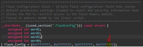

This pin may cause the problem. LLWU3 is PTA4. And its default function is NMI_b. If you do not disable the FOPT[NMI_DIS], the NMI pin reset default to enabled. So I think change the pin or disable the FOPT[NMI_DIS].
TIC
9,090件の閲覧回数
dbwolfe
I changed the flash option array in startup_mk22f25612.c as shown:
This should disable NMI interrupts, as well as EzPort.  I'm still seeing the same problem though.

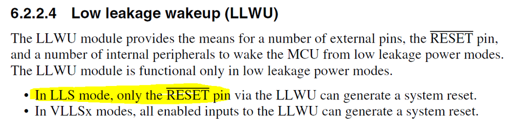

After the "wfi" command the processor will move to LLS mode and this can indeed be tested with debugger connected if you don't mind the debugger disconnecting.
As you will be aware a wake-up fro LLS is always via a RESET so whether reset from a LLWU pin or RESET pin the entry into it is the same.
Once you can get the LLS mode you can then check resetting via LLWU.

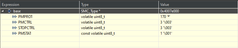

I included the LLWU setup code in my previous reply just to show that the pin was set correctly for waking from LLS, I get that it doesn't affect LLS entry.
Regarding the code snippet you included:
I confirmed that PMPROT is being set correctly.  Reading the register directly before LLS entry shows that it is set to 0xAA, which per the reference manual means that HSRUN, VLP, VLLS, and LLS modes are allowed.  In any case, I believe that if I tried to enter into a dis-allowed power mode the STOPA stop abort bit would be getting set when the PMCTRL stop mode control bits were set, and I'm not seeing that.
Digging into the SMC_SetPowerModeLls() function from the SDK, it is basically following the code you posted.  Your code explicitly sets the run mode control bits to run, and the stop mode bits to LLS, where the the SetPowerMode code just keeps the current run mode bits and sets the stop mode bits to LLS.

The green LED flashes at 2.5Hz when running and there is a menu on the UART (115kBaud). In the Administrator menu one can check the present low power mode and change to different ones. VLLS modes can be exited by pressing SW2 (LLUW_6) - which causes a reset.
Note however that LSS modes can only be exited by using the RESET button (see the user's manual):

I tried making a little "while" loop that reads the power mode status register and waits for it to be set to
The SDK function seems to be setting the stop control register correctly.  The code is as follows:
reg = base->STOPCTRL;
reg &= ~(uint8_t)SMC_STOPCTRL_LLSM_MASK;
reg |= ((uint8_t)config->subMode << SMC_STOPCTRL_LLSM_SHIFT);
base->STOPCTRL = reg;
base is a pointer to the SMC base address
SMC_STOPCTRL_LLSM_MASK = 0x7, so an AND with the complement clears the lower 3 bits of stop mode control
config->subMode = 0x3 in this case, for sub mode 3, and SMC_STOPCTRL_LLSM_SHIFT = 0, so it isn't shifted
The results is that after this code is run, the stop mode control register is set to 0x3 - partial stop = normal stop, POR enabled in VLLS0, stop mode = LLS3
The only thing that seems different from the uTasker code is POR being enabled for VLLS0, and possible the partial stop options.  Can you check the exact value being written to the stop mode control register by your code?  I'm wondering what LP_PARTIAL_STOP_1 and LP_PARTIAL_STOP_1 are defined as.
Devin

Before setting low leakage stop mode:
After setting LLS2:
Or after setting LLS3:
Plus of course the SLEEPDEEP flag set in the Cortex-M4 system control register.
All of the optional flags are 0.
