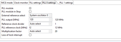

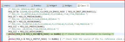

Facing issue while initializing PLL clock for Processor MK60FN1M0VMD12. Code execution is not going beyond below image:

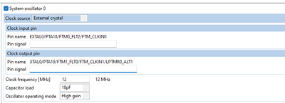

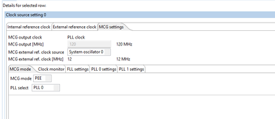

Below is the configuration setting in processor expert:

I recommend you consult the app note AN3208 Crystal Oscillator Troubleshooting Guide.
Hope it helps you.
