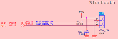

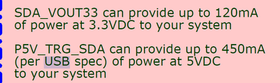

Hi, apologies for not understanding the terminology, do you mind explaining what the J199 is for the FRDM-K64F, I couldn't find information on what that is.
If what you've mentioned that the 3.3VDC can provide a maximum of 120mA, then it is likely that the ESP8266-01S is consuming more than that during immediate connection as it can spike up to 430mA. Its likely I will have to use a separate 5V input and use a level converter to step down to 3.3V.

Pavel_Hernandez
Hello, I attached the image from the schematic about the max current with the USB cable is 40ma. Maybe you could use a USBmeter to check the maximum current with devices attached.
This is the J199 that was mentioned on the thread that you put in your last message, did you test it here?

Pavel_Hernandez
Hello, my name is Pavel, and I will be supporting your case, I reviewed the thread and your issue, but I need more information, what is the behavior if you use the same J199? What is the power consumption in total?
this is the maximum using USB as a power supply.
