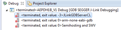

jqwang
I suddenly cannot start J-Link debug. I checked the J-link ok @FRDM-K22F board.
Log info:
SEGGER J-Link GDB Server V4.98d - Terminal output channel
Connection closed by the GDB server.
Exception condition detected on fd 0
Quit (expect signal SIGINT when the program is resumed)
error detected on stdin

Connecting to target...ERROR: Could not connect to target.
Target connection failed. GDBServer will be closed...Restoring target state and closing J-Link connection...
Shutting down...
Please check power, connection and settings.
please suggest how to solve this issue.

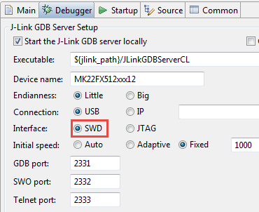

another consideration:
are you using JTAG or SWD?
Your log shows
Target interface: JTAG
but the FRDM-K22F has SWD.

jqwang
Hi Erich,
thank you! My hardware is using jtag.
Is there a way to configure my debug port to SWD, although they're wired as JTAG.

BlackNight
5,012 Views
jqwang
thank you!
we found the hardware wire connection is wrong. The J-link Reset pin should be connected to MCU chip reset signal  reset_b, instead of jtag-TRST.
