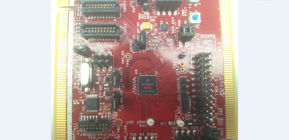

Kan_Li
Hi Alex,
The mask set is on the surface of the device, right below the part number, and it is related with the silicon revision, so having it would be helpful to locate the cause. Please kindly refer to the following for details.
The snapshot shot is from TWR-K21D50M, and the device on that board has the 0n89e mask set.
