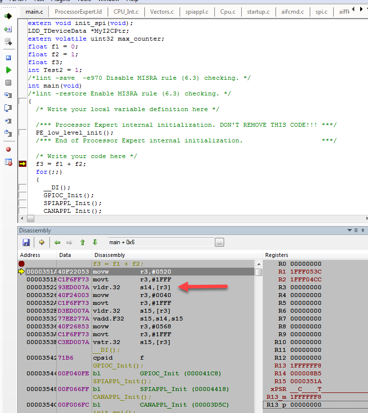

I do have a project based on ProcessorExpert where I now start with some calculation.
I'm using
  • MK22FX512VMC12
  • ProcessorExpert 10.4.0 b140319
  • winIDEA 9.12.157
  • GCC arm-2013q3
  • No RTOS
Up to now everything worked fine so far. Now I'm trying to scale some measurement values and with the first math instruction I enter hardware fault exception (vector #3).
I guess that I doing something wrong in software but I don't know what.
My settings may be wrong - but floating point settings seems to be OK.
Compiler:
-c $(EDNAME) -mthumb -mcpu=cortex-m4 -mfpu=fpv4-sp-d16 -mfloat-abi=hard
-gdwarf-2  -Wall -ffast-math -fomit-frame-pointer
-I$(IRFDIR)\Generated_Code -I$(IRFDIR)\Sources
-I"%PROCESSOR_EXPERT_PATH%\lib\Kinetis\iofiles"
-I"%PROCESSOR_EXPERT_PATH%\lib\Kinetis\pdd\inc"
-D__GNU__ -D__PE__‍‍‍‍‍‍‍‍‍‍‍‍‍‍‍‍‍‍‍
Linker:
-Wl,-T,$(INDPATH) -Wl,-Map,$(OUTPUTDIR)\kernel.map,
--gc-sections -o $(OUTPUTPATH)‍‍‍‍‍‍‍‍‍
I do not understand why an instruction
vldr.32 s14,[r3]‍‍‍
causes the hardware fault excpetion. The CPU has an FPU, so it should work.
It would be great if anybody can help me with that.
  • Do I have to ENABLE the FPU? (If so where do I find it in PE?)
  • Is there an error in the command line of compiler or linker?
Thank you very much
Thomas

Hi Thomas
CPACR |= (0xf << 20);                                                // enable access to FPU
Mark

thomas_k1
Hi Mark, Earl,
thanks for your answers.
I now find the SCB_CPACR block and can use it to setup FPU in C.
As beginner with ARM it was a good lessen to learn about standard parts and ARM information center :-)
regards
Thomas

thomas_k1
Hello Mark,
thanks a lot you for your hint - it solved my problem.
If someone has the same problem and is reading this thread and now searching for CPACR register: I neither find in in my headers nor is it documented in the Kinetis K22 Sub-Family Reference Manual. Use "CPACR" to find other threads which provide an assembler snippet to enable  FPU access
Thanks again to Mark!
Thomas

Thomas
The Cortex-M4 core is not described in the user's manual because it is a 'standard' part from ARM. That means that anything to do with the core is fully documented by ARM at their "ARM Information Center". For enabling floating point see http://infocenter.arm.com/help/index.jsp?topic=/com.arm.doc.ddi0439b/BEHBJHIG.html
Mark
P.S. Since the register is memory mapped it doesn't need any special instructions to access it so I would avoid assembler code (to ensure portability). If your framework doesn't supply it just add
#define CORTEX_M4_BLOCK                    0xe000e000
#define CPACR *(unsigned long *)(CORTEX_M4_BLOCK + 0xd88)                // Co-processor Access Control Register

egoodii
Senior Contributor III
FYI, the MK22FA header file I access calls that SCB_CPACR, as part of the whole System-Control-Block at 0xE000E000
