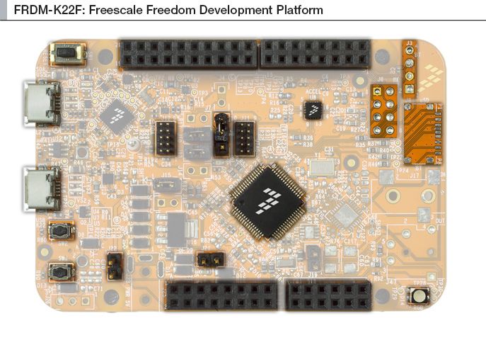

I use the eval board FRDM K22F 120.  I could build and load the software after building all the necessary libraries:
C:\Freescale\Freescale_MQX_4_1\mqx\build\iar\bsp_frdmk22f120m (and psp)
C:\Freescale\Freescale_MQX_4_1\usb_v2\usb_core\host\build\iar\usbh_mqx_frdmk22f120m

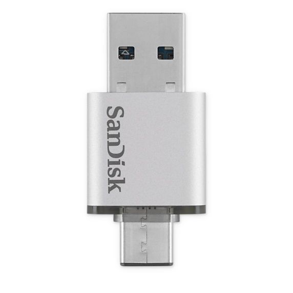

After loading, I connect the "Power Open SDA Debug micro USB" (the mini USB port closer to the side) to my PC and I could see the printf printed via serial port 115200 baudrate.  Then I plug in a dual-drive USB (that has been formatted as FAT32) into the K22F micro USB (the mini USB port in the middle).  But the Freedom doesn't recognize it.  No interrupt whatsoever seems to be generated.

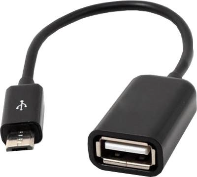

2) Do I need a "Micro USB OTG adapter" before plugging in? (At least the pdf here mentions I should use this adapter USB Host Project with KSDK 1.3 and Processor Expert )

I found the Eval Board Freedom 22F Schematic and found that I need to connect Jumper J22 to make it a USB host.
From the reference manual it seems like the circuitry for Host requires additional connection (thus jumper J22 on the eval board).
After connecting the jumper J22 I could get DEVICE_ATTACHED and DEVICE_DETACHED event. =)
