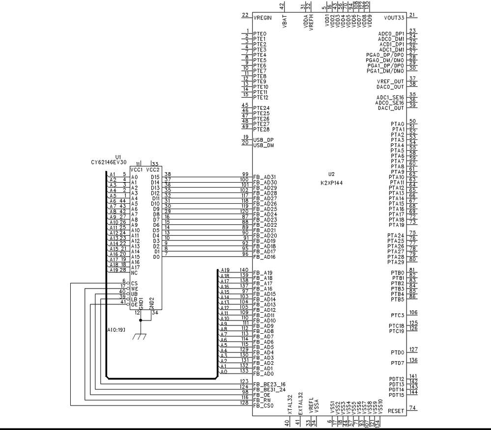

I am designing with the K22FX512AVLQ12 in mind.  I have a memory interface I put together based on what I understood of the FLEXBUS in the K22P144M120SFV2RM.pdf reference manual.  However I have seen several comments in Freescales community boards about problems people are having using a x16 bit data bus.  AN4393 doesn't talk about using a non-multiplexed interface for a x16 bit data bus.  So, before I make a board, I wanted someone to advise me that this design will work, and if there are other limitations with it if it does.  For example, can it read/write an odd or even byte without affecting the corresponding even or odd byte?  Will a 32-bit aligned read or write actually result in two memory cycles to the SRAM? Will non-aligned reads and writes work?  If the design does work, it should be added to AN4393.
Also, Table-4-1 of the reference manual shows the FLEXBUS to be in 5 different regions of the memory map.  The comments I have seen recommend using the "External Peripheral" space.  "write-back" and "write-through" suggests a cache, but there is no mention of a cache for the FLEXBUS in the reference manual.
3,473 Views
Hui_Ma
Hi Adam,
There should without problem for customer to use 16-bit data port with non-multiplexed mode.
When using the non-multiplexed mode, customer need to make sure the Flexbus pin resource is enough for the application.
For using 16-bit data port, the FB_AD0 pin is obsoleted as address pin, it just read the data with 16 bits (2 bytes).
If there exists address non-aligned, there still could read data out, while it will take more cycles (time).
It could read the odd byte and even byte with byte enable signal.
Wish it helps.
Ma Hui

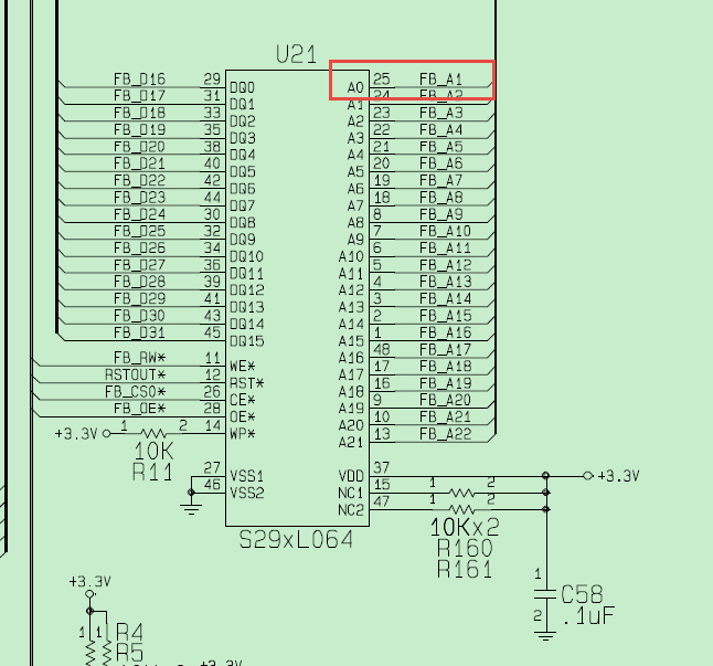

Can you please take a look at the attached schematic and let me know if your answer is still valid?
Adam
3,473 Views
Hui_Ma
Yes, I think customer using FB_AD1 connects with SRAM's A0 is quite right.
Customer need to config Flexbus port size to 16-bit.
For the Kinetis Flexbus module is original from ColdFire product, I attached a ColdFire product MCF54451 Flexbus connects with NOR Flash (16-bit data port) for your reference:
