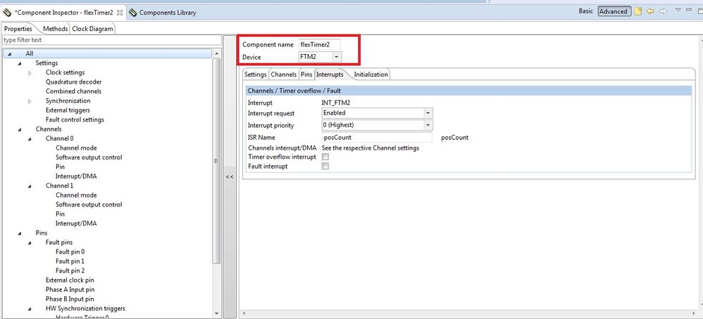

kent_gu
Hi, Xiangjun,
Thank you a lot for your reply, it is helpful. Yes, I saw the demo code in the page 18 of an5142, there is quadratureDecoder intial and period interrupt. Now I want to pop up the counter value when encoder PHA & PHB happen, so I want to use the processor express to realize the code. But I don't know how to setting?FTM_QD.jpg
Could you please give me some advice?

kent_gu
Anyone have any input about, "want to pop up the counter value when encoder PHA & PHB dual edge"? It means that at  the dual edge of PHA & PHB trigger interrupt, and enter ISR?

xiangjun_rong
Hi, Kent,
where do you want to pop up the FTM counter? I think you can use Freemaster tools to display the FTM counter, in the case, you can read the FTM counter to a variable in the main loop so that Freemaster tools can display the variable. As an alternative, you can use PIT to generate an interrupt, in the ISR of PIT, read FTM counter to a variable so that the Freemaster tools can display it.
If you use UART module to transfer the FTM counter, you can read the FTM counter in the ISR of UART.
Hope it can help you.
Xiangjun Rong
