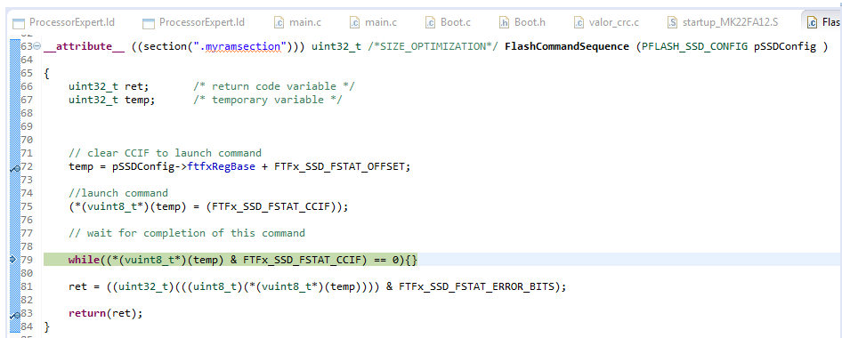

Hi all,
Im working with MK22FN1M0AVLL12. It has 1MB of flash (2 flash blocks and no FlexNVM memory)
My code is into block 0 and the issue happens when i try to erase a sector which is into this block 0. (erasing into block 1 is ok).
I am not using any interrupt so I guess it is because it is not possible to execute code and erase a sector which is into the same block at the same time, am i right?, should i execute the erase and program code from RAM so it can works?
I did the same (execute code from flash) in a K60 which only had one flash block and then i could erase and program a sector successfully, why??
Maybe it is because it is only posible to erase a sector executing the code from flash in MCUs that only has one flash block???
Thanks and best regards.

I have resolved the issue.
It was due to some code macros which were called inside the "FlashCommandSequence" function.
they should me relocated in RAM also or just put the code without the macro into the function which is already alocated in RAM

Sorry but I don't understand the code you have posted, i mean, inside fnFlashRoutine you clear the CCIF bit, which launches the command (this code should be in SRAM)
By the way i have tried to do the error checking back in flash but it doenst go any better.

The code is run from SRAM; notice that fnRAM_code() is called rather than the reference routine.
In fact I actually use this:
static unsigned short fnFlashRoutine[] = {                               // to avoid potential compiler in-lining of the routine (removing position independency) the machine code is used directly
    0x2180,    // MOVS   r1,#0x80                                           load the value 0x80 (command complete interrupt flag) to register r1
    0x7001,    // STRB   r1,[r0,#0x00]                                      write r1 (0x80) to the passed pointer location (r0)
    0x7801,    // LDRB   r1,[r0,#0x00]                                      read back from the same location to r1
    0x0609,    // LSLS   r1,r1,#24                                          shift the register content by 24 bits to the left so that the command complete interrupt flag is at bit 31
    0xd5fc,    // BPL    -4                                                 if the command complete interrupt flag bit is '0' (register content is not negative value) branch back to read its value again
    0x4770     // BX     lr                                                 return from sub-routine
because it avoids any risk of different compiler and optimisations from causing it to fail (for whatever reason) and assures that the amount of bytes located in RAM remain identical in each case.
There is another question recently with the same (random) LOCK UP behavior:
inconsistent 'LOCKUP' reset when programming Flash Memory
My only explanation is that there are interrupts causing this to happen....

Hi Mark,
The solution is to disable the interrupts. But why? i don't use any interrupt in the project.
I have put the code "__asm ("cpsid   i");" at the beggining of the main and now the board is not resetting.
Thanks for your help and best regards.

You must have been using interrupts somewhere (like timer) without being aware of it.

Mark,
You are right, there was a system interrupt "Sys Tick" selected.
It was in "fsl_os_abstraction" component
I have remove it and now this "__asm ("cpsid   i");" instruction is not needed.
By the way, this interrupt was enabled by default when i created the project.
Besides, why does this issue happen only when i try to write in block 0?
Thanks again and regards

I have just placed the function "FlashCommandSequence" in RAM but i am facing the same issue.
The MCU resets when i erase a sector which is in block 0
I forgot to say im using C90TFS drivers.

As you see i have had to put the Macro's code instead the macro itself otherwise i couldn't write code in flash block 0.
This way the whole function is alocated in RAM "myramsection"
So i have had to modify library code.
In any ways it works fine in block 0 as long as i am debugging step by step. I mean going over the "FlashEraseSector" function by one step, then let it run still "FlashProgramSection"  function and then go over it by one step too.
If i let the code run, the MCU resets.
I have put a delay between the sector erase and the sector program but nothing has changed.
Any idea or test that i can do?
Thanks and regards

If you are not using interrupts (or interrupts are disabled) there is no reason why the routine would fail as long as all is in SRAM.
However I see that there is a callback in the code that is called while waiting for the Flash operation to complete - this will not be called when stepping the code but would be called when running at full-speed.
Make sure that this routine is also in SRAM in case it is used. Or set it to 0 if you don't want it to be called - ensure that it is set and not left as a random value since it would otherwise also cause a crash.

The last thing i have seen is that the furthest it goes without being reseted is the break point which is inside the disassembly window.
This breakpoint belongs to the "while".

It looks like the while loop is never being quit - do you have the watchdog active? Also, when there has been a reset do you know what the reset controller reports as cause for the last reset?
The code looks Ok but it has been written in a way to make it as difficult to understand as possible....the following is easier to understand but exactly the same (there is no need to do the error checking in the RAM code - you can do it after it has returned.
static void fnFlashRoutine(volatile unsigned char *ptrFTFL_BLOCK)
    *ptrFTFL_BLOCK = FTFL_STAT_CCIF; // launch the command - this clears the FTFL_STAT_CCIF flag (register is FTFL_FSTAT)
    while ((*ptrFTFL_BLOCK & FTFL_STAT_CCIF) == 0) {} // wait for the command to terminate
and called with
fnRAM_code((volatile unsigned char *)ADD_FLASH_STATUS_REGISTER);  // execute the command from SRAM
