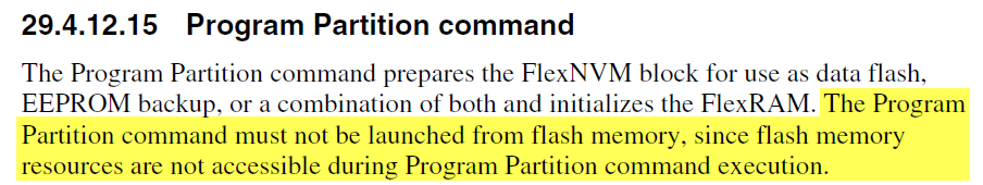

Hello al1:
The part of code for launching the program partition and waiting for it to complete should be placed in RAM space. With the debugger it works because the core does not try to read the next instruction from flash right away, giving the command enough time to finish. Below is an extract from the reference manual:
The syntax to locate code in RAM is compiler dependent.

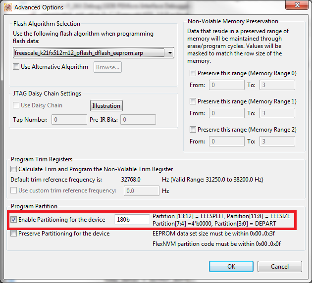

Replying to my second question in the previous reply, I found where the partition settings can be programmed initially inside KDS without the need to worry about configuring it while code is running.
under the debugger tab the advanced tab will show this window:
In red is where I set up the partition I want during the programming process.
My first question still out, is there a simple example on how to relocate into RAM let's say the line FTFE_FSTAT = FTFE_FSTAT_CCIF_MASK which will quick start the partitioning of the internal memory?
