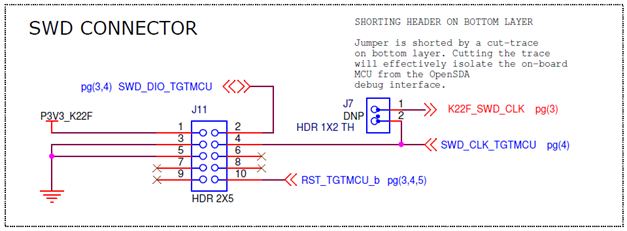

I am designing a PCB for Kinetis K22 and have some confusion in SWD connector pin configuration.
There are two different configurations available, one is SWD connector in FRDM-K22F schematic (TDI and TDO pins are not used).
The other configuration is available in user manual of PE Micro U-Multilink (TDI and TDO pins are used).
I would like to know about the difference in these two configurations (how is it possible to program microcontroller without TDI and TDO pins)?

Hello Saad,
This MCU supports SWD and JTAG debug interfaces. SWD needs only DIO and CLK lines while JTAG needs TMC, TCK, TDO, TDI and RESET lines.
I recommend you to take a look into this document from ARM where the differences between SWD and JTAG are explained.
Earl.
