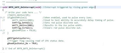

In my application running on a MK20DX256VLK10  there are several interrupts.  One is a rising edge external interrupt set to maximum priority. The other interrupts are set to medium.  Inside the external interrupt is some code (see attached) to set a discrete out, wait then clear the discrete out.  What I can see is that the discrete pulse (red) is occurring approx 11.3us after the rising edge signal triggering the interrupt (green) and also that the time varies up to about 4us (location of trailing edge of red pulse).
When the if conditional is uncommented so the code inside the interrupt executes periodically (every 1s) then there is additional variability in the time to service the interrupt.
What is causing the 4us servicing variability?
Why is the interrupt serviced approx 11.3us after the edge input trigger source?
Thanks!

However I'm most concerned not with interrupt latency but with the execution jitter within the interrupt.  The latency appears to be mostly fixed.  The timing jitter setting the discrete output is the problem.
The requirement is to set the discrete output a specified amount of time (Xus +/- 0.25us) after the rising edge of the green trace.  So an event interrupt is triggered on the green rising edge and code to set the discrete out is executed from within the interrupt.  However there is significant timing jitter setting this discrete.
How to reduce greatly or eliminate this jitter?

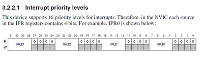

For the interrupt jitter for each pin interrupt, the interrupt latency is dependent on the where the core executes when the interrupt happens. If it executes the code in main or the subroutine, the core will jump to the ISR immediately after pushing the predefined registers to stack. If it executes the code in the other ISR, as you know that cortex-M4 supports nested interrupt, the core will check the priority group bits, if the current interrupt has higher priority,  the core will jump to the current ISR after pushing the predefined registers to stack. BTW, if the the core execute the atomic operation, the core will jump to ISR after the current atomic operation has finished.
In conclusion, pls configure the pin interrupt priority level to 0x00, which is the highest interrupt priority. Set the other module interrupt priority level as for example 0xF0, which is the lowest interrupt priority so that the Port pin interrupt can preempt the other interrupt.

It is hard to know for sure what the timing error is.  The green trace is the pin input that triggers the interrupt.  The pink trace is the pin output set from within the interrupt.  So either there is latency jitter of the interrupt being serviced or there is execution jitter within the interrupt.  When the original scope shot was taken, the pin input interrupt was already set to highest priority (0x00). All other interrupts are set to medium.
Any other things to track down to eliminate the jitter?  I would think it should be possible to have the pin output set a fixed amount of time from the pin input.
