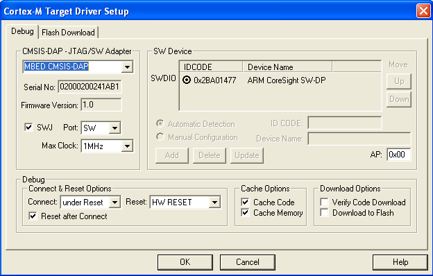

First of all, I can try to access target K20 with CMSIS-DAP for communication, all of them can be detected in Keil MDK.
The SWDIO is: 0x2BA01477,
If I remove the target, this SWDIO will be "SWD/JTAG Communication Failure".
If I connect it to KL25Z on board, the SWDIO will be "0x0BC11477".
By this setup dialog, I know the K20 is hooked up.

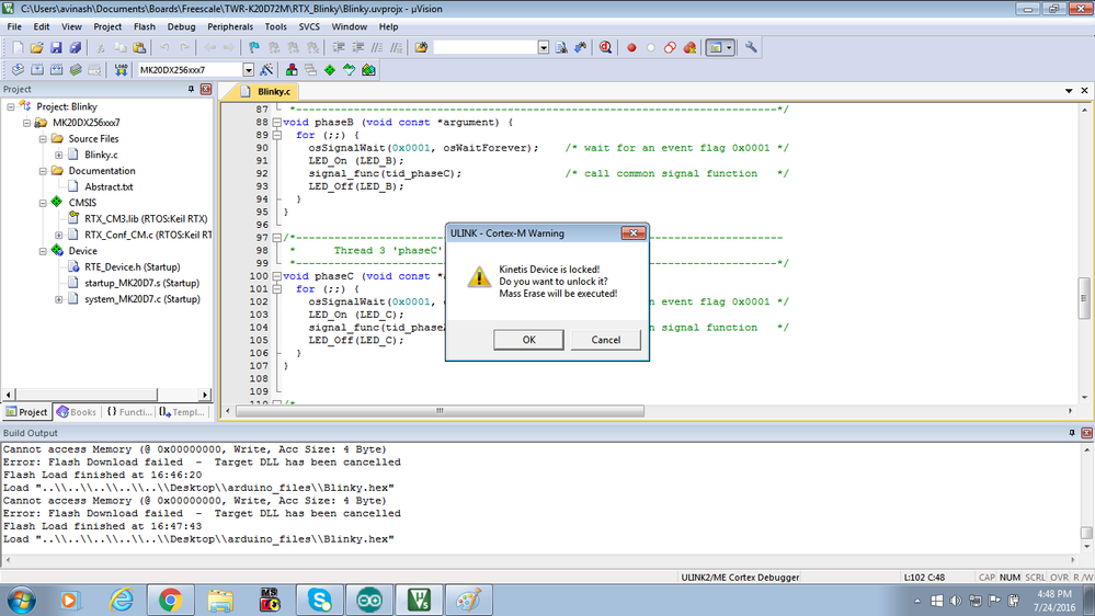

Then I tried "Erase" command from pull down menu.
The system warns me: Kinetis Device is locked and it will execute Mass Erase command. So I click OK.
Another warning, can not access memory.
Finally, it warns me Flash Erase failed.
Then I tried it in IAR EWW 6.7. Same result for Erase all command. With different warning message: Reading CPU status failed.

I'm getting the same Problem in MK20DX256VLH7 via JLINK2 and flashing via SWD mode.
I have connected data via 100K Pull-up, Clk with 100K pull-down and directly connected reset.Untitled.pngUntitled1.pngUntitled2.png
Kindly help.
Attached is the screen shots.

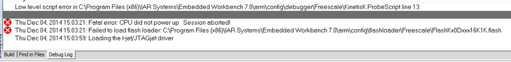

nesrinemhiri
Hi Kai Liu
when i see the EWARm debug log , you use the FlashKx0D!!!.board but you should use the FlashK20Xxxx.board
I hope that can help
have a nice day
Nesrine

huishao2
Hi -
I got similar lock-up issue after issuing "Erase All Blocks Command" (0x44) from my code. My k20d50m can't be programmed anymore by IAR/I-jet.
Below is the error  message I got from IAR.  Just wondering if there is a solution figured out there?
thanks!
Hui

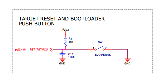

Hello Kai Liu:
Have you checked if the reset line is oscillating? I ask because you mention it is a new part.
To avoid problems with new parts it is recommended to place a 4.7K - 10K pull-up in the RESET_b line, and also a 100 nF capacitor to ground.
Regards!,
Jorge Gonzalez

kai_liu
Senior Contributor I
Hi, Jorge,
I have tried your suggestion in two steps.
1) remove 10K to ground, only 4K7 pull up, still locked.
2) add 100nF to ground, still locked.
Only 2.77V DC.
I will tried PEmicro multilink, JLINK clone and CoLinkEx.
Currently SWDIO is accessible, but RAM/ROM access is forbidden. I don't know how to access it in EZP mode. But I think it will be rejected as well.
Thanks for your suggestion.

kai_liu
I have checked the reset pin because I have heard about it.
After reset the RESET_b is high at 2.7V by 4K7/10K divider, no caps to ground. That circuit comes from RESET part of OpenSDA. There are two kinds of reset actually.
MK20DX128 of OpenSDA is reset directly by resistor divider, 5V * 10/14.7 = 3.4V. I measured the locked one with 2.7V DC, no oscillation output. The other working one is stable at 3.3V. I will replace 10K to ground as 100nF cap to check out difference.
EZP_CS_b is high by 10K pull up.
Just a few moment ago, one of my working board is locked as well. I reconnect for several timers, then I found it can be reprogrammed again. I don't know why. However it was a uncertain factor in future production.
