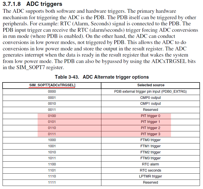

Thanks for your suggestion, and  i'm try to using PIT to trigger the conversion, but i found the conversion do not happen.
In the following routine i use PIT3 as the timer, after 500*BusCLK,  hope can get the ADC data, using "ADC_FLAG" to mark whether the data is read by other ISR Handler or routine.

Robin_Shen
Hi Jack,
You need selected PIT as HW trigger for ADC (see SIM_SOPT7 register description).
Robin
