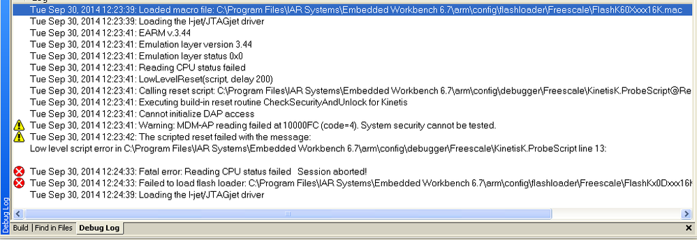

Then I tried it in IAR EWW 6.7. Same result for Erase all command. With different warning message: Reading CPU status failed.
Here is the full log message, it shows DAP access for reset is failed.

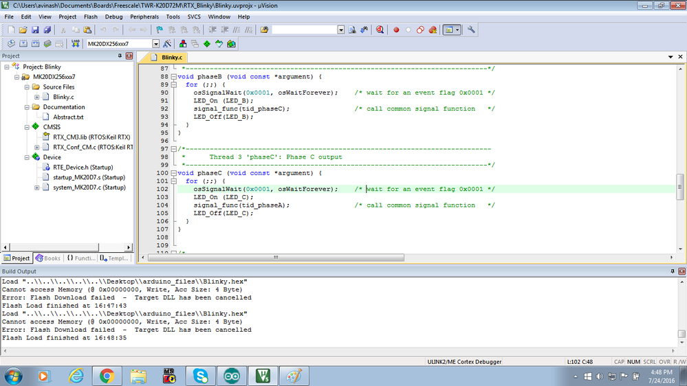

I'm getting the same Problem in MK20DX256VLH7 via JLINK2 and flashing via SWD mode.
I have connected data via 100K Pull-up, Clk with 100K pull-down and directly connected reset.Untitled.pngUntitled1.pngUntitled2.png
Kindly help.
Attached is the screen shots.

Hi Kai Liu
when i see the EWARm debug log , you use the FlashKx0D!!!.board but you should use the FlashK20Xxxx.board
I hope that can help
have a nice day
Nesrine

To be frank, I have not configurate that by myself. It should be selected by default from frdm-k20d50m-demo. I disabled Override default .board file in Debugger | Download tab.
The grey out one is : $TOOLKIT_DIR$\config\flashloader\Freescale\FlashKx0Dxxx16K1K.board
There is no FlashK20Xxxx.board in IAREW v6.7 & v6.5.
I will tried it in EWARM again.
But it failed in MDK as well, which I used mbed source code for testing. I believe it is well configurated.

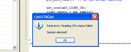

I got similar lock-up issue after issuing "Erase All Blocks Command" (0x44) from my code. My k20d50m can't be programmed anymore by IAR/I-jet.
Below is the error  message I got from IAR.  Just wondering if there is a solution figured out there?
thanks!
Hui
