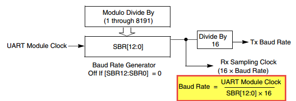

You can take a look into this thread​ to see how the baudrate is calculated, especially the information that I have copied below.
In the reference manual you can see that the baud rate is generated as follows:
So the SBR value can be calculated:
SBR[12:0] = UART Module Clock / (16 * Baud rate)
The UART Module Clock is the bus clock which does not seem to be configured. By default the Bus Clock is 20.97152 MHz, so:
SBR = 20.97152 MHz / (16 * 115200) = 11.3777
I suggest to change the bus clock to 48 MHz, it will produce a more accurate baud rate:
SBR = 48 MHz / (16 * 115200) = 26.0416
