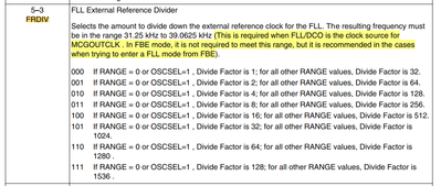

As indicated by the reference manual (table 30-3), it seems that the correct value for MCG_C2[RANGE] should be 0b1X (very high frequency range) for a crystal oscillator which oscillates more than 8MHz.
After investigating, I believe the issue is related to the FLL input frequency requirements. According to the Reference Manual, the FLL requires an input frequency in the range of 31.25 kHz to 39.0625 kHz.
With a 12MHz crystal and MCG_C2_RANGE=2 (very high frequency range), the available FRDIV options produce:
  1. FRDIV 256 -> 12MHz/256 = 46,8kHz -> Too high
  2. FRDIV 512 -> 12MHz/512 = 23,4kHz -> Too low
None of the available dividers can bring the 12MHz reference into the valid FLL range, which appears to prevent the MCG from accepting the external reference, even in FBE mode where the FLL output is bypassed.
->> Yes, you are right. MCG_C2[RANGE] should be 0b1X. Sorry for the previous misunderstanding.
Is my analysis correct? Does the MCG indeed verify FLL input frequency validity even in bypass modes (FBE), preventing the transition with out-of-range frequencies?
->> It does make sense. However,  I don't think the frequency range of the FLL in FBE mode must be between 31.25 kHz and 39.0625 kHz. Please check below.
