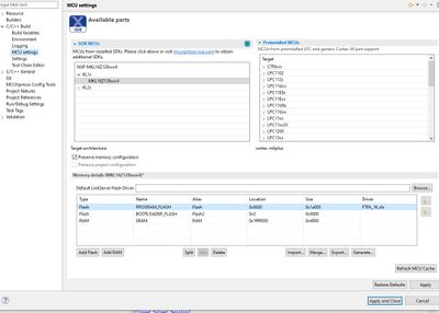

I am attempting to create two partitions of flash, one for a future bootloader and another for the main program.
I set the bootloader to be from 0x0 to 0x6000 and the main partition to be from 0x6000 to 0x20000 as seen in the image below.

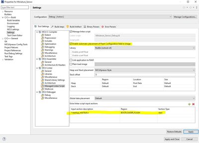

I don't really have a bootloader at this point but instead I attempt to place the file startup_mkl16z4 in the bootloader partition so the system can startup correctly. Note that I have "Enable automatic placement of flash..." selected at this point.
When I do this and compile I get an error that says "Linker Flash Config Support Enabled, but no .FlashConfig section provided within application". To prevent that error I placed a flash config table (copied from startup_mkl16z4) at the top of main thinking that a flash config section needed to be in each partition of memory since there is already one in bootloader section because of the startup file. This prevents the compile error.
When I load the software with this configuration it does not work. When I view the memory through the debugger it appears that the flash config table is being placed at the very beginning of the flash instead of the vector table and I am not sure why.
I have found that I can get the program to run if I remove the flash config table before main and deselect the option "Enable automatic placement of flash..." in the managed linker script.
