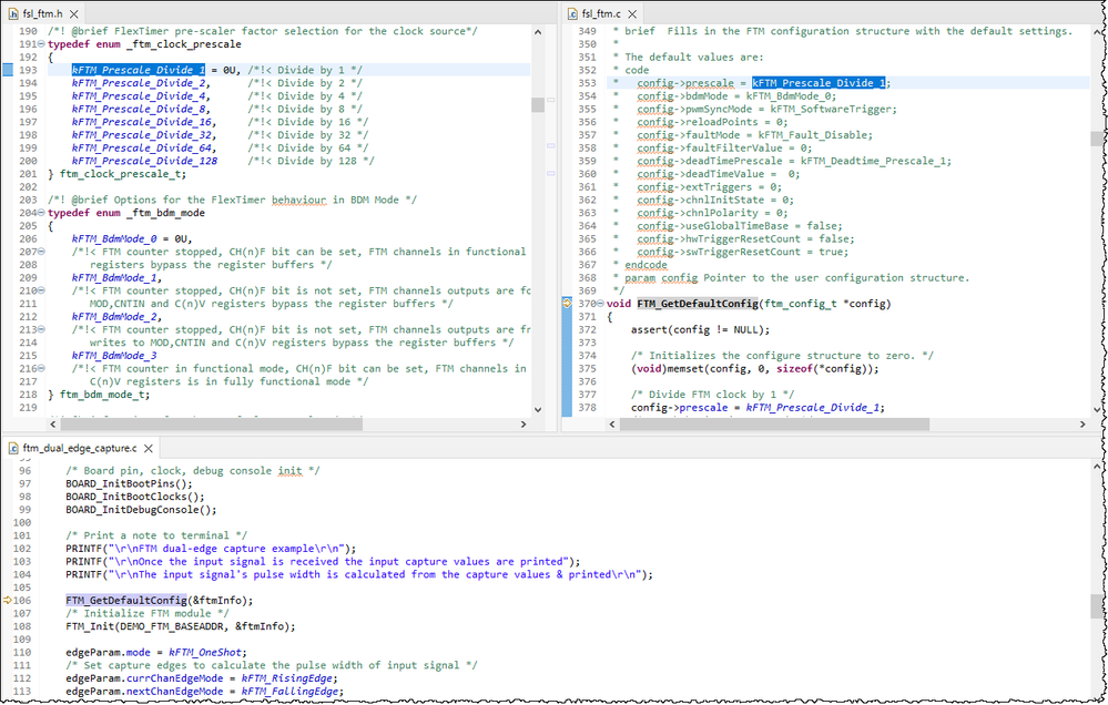

If you don't want the FTM timer to overflow frequently, you can change the FlexTimer pre-scaler factor selection for the clock source so that its period is greater than 10us.
FTM_GetDefaultConfig select the default prescale = kFTM_Prescale_Divide_1;

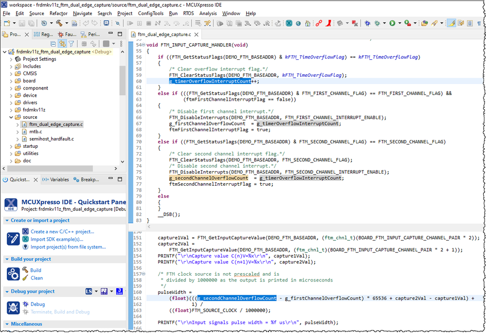

I think you can refer to the frdmkv11z_ftm_dual_edge_capture example in MCUXpresso SDK. It will show you how to handle FTM timer overflow when dual edge capture is used to measure pulse width.
