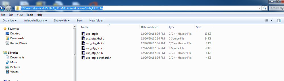

We have provided the api function for otg of usb in only SDK2.1 version, but currently, there is only SDK2.0 version package for Kl26.
I have downloaded the SDK2.1 for FRDM-K64F, there is otg directory in the SDK package, if you are urgent, you can refer to it. But we have not example for otg.
