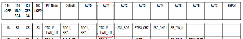

Have you try to select PTC11 as GPIO function?
Please refer the image shown below:
Robin

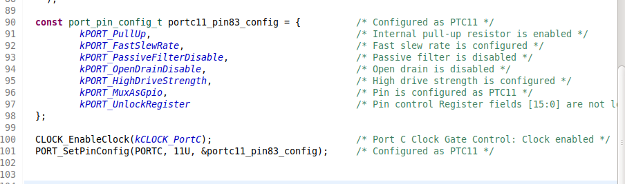

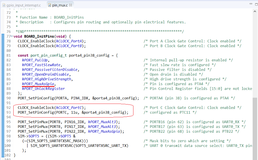

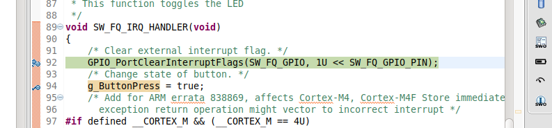

javierhernande1
Sorry, I am a mess with C.
Now works. Thank you.
