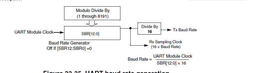

Also I need to set the UART baud rate to 115200. I tried the changing the BDL & BDH  values, but the values seems to be uncorrect.
For 115200, I  assigned BDL= 7 and BDH = 0.. Some of the characters displayed in putty is not correct???
By default the baudrate was 9600, BDL = 128 and BDH = 0.. All characters display correctly. Could you please explain the logic/theory of setting the BDH and BDL for correct values?

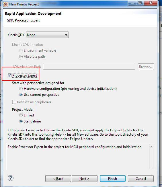

(1) On KDS, when you create project for your board , you can select the chip of SKEAZ128xxxx4,
this is the chip of your board .  And yes, the ksdk doesn't support this chip, while , you can select
the Processor Expert(PE) when you create project , also can create bare board project (without PE).
(2) About the UART baud rate ,  i don't know what the value of other register about it , so you can refer to
the formula to calculate :

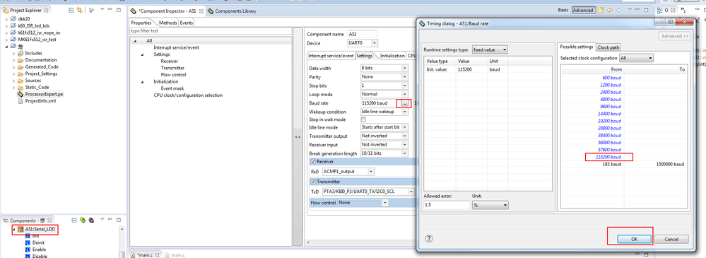

or if you create one PE project , you can directly configure the baud rate on the UART
component view:
