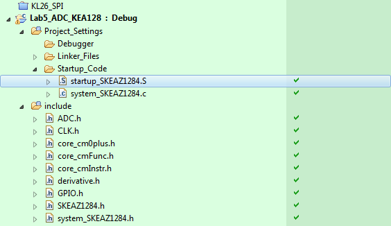

I am using FRDM DEV BRD KEAZ128 and S32.
I am trying to understand how interrupts are working. Lets take as example from FRDM-KEA-QSP package example project Lab5_ADC_KEA128 where ADC generates interrupt after every conversion. How does processor understands what it needs to go to void ADC_IRQHandler() function ? This function is not described in the main(). Can I give for interrupt handler function any name (for example my_adc_irq () ) or it must have fixed name? If yes where are these names described ?

Hui_Ma
Customer could find the __isr_vector table located at <startup_SKEAZ1284.S> file.
It will indicate the ADC module interrupt service routine related ISR function is ADC_IRQHandler.
