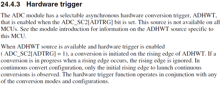

Hi Irmantas Budrys,
Please read the "24.4.3 Hardware trigger" of KEA128RM.pdf. See below:
When hardware trigger is selected, a ADC conversion is initiated following the assertion of the ADHWT input.
And you need selects "PIT channel0 overflow" as the ADC hardware trigger source.
Robin
