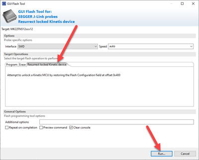

As shown in the figure:
May I ask that the Debug was closed through PE configuration last time, but it cannot be burned in now, is there any solution?

ErichStyger
Specialist I
The easiest way is to use the P&E Multilnk (it can be a 'normal' one), with the PEMICRO Recovery utility, see https://mcuoneclipse.com/2021/05/20/recovering-cortex-m-microcontroller-with-a-power-glitch/ and https://mcuoneclipse.com/2013/06/16/bricking-and-recovering-frdm-kl25z-boards-reset-swd-clock-and-lo...
For the above you need the PEMicro debug probe.
If you have a J-Link, then you can try the 'resurrect locked Kinetis device' in the MCUXpresso IDE, see
There is a command line way too, see https://mcuoneclipse.com/2014/10/05/unlocking-and-erasing-flash-with-segger-j-link/
I hope this helps,
Erich
