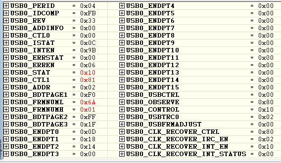

The following are relevant configurations with regard to the crystal-less USB device operation:
SIM_SOPT2 |= (SIM_SOPT2_USBSRC | SIM_SOPT2_PLLFLLSEL_IRC48M); // set the source to IRC48M - value = 0x0404000
USB_CLK_RECOVER_IRC_EN = USB_CLK_RECOVER_IRC_EN_IRC_EN; // enable 48MHz IRC clock and clock recovery - value = 0x02
USB_CLK_RECOVER_CTRL = USB_CLK_RECOVER_CTRL_CLOCK_RECOVER_EN; // value = 0x80
Finally, here is a screen shot of the USB registers when paused during the operation.
I can operate for long periods of time with the USB without any USB difficulties - the drift is the only problem. This tends to suggest that there is crystal-less synchronisation for reliable USB but the synchronisation is not adequate to actually lock the IRC48M to the host time base.
I look forward to your evaluation.
