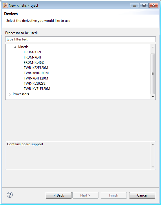

I've installed KDS 3.1.0 and I don't have options to generate new project for it.

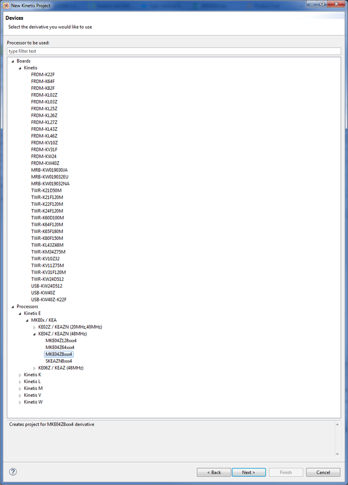

Hello IIKKa,
You can directly choose the Processors of "MKE04Z8VFK4"
As so far, there is no Boards option for FRDM-KE04Z, select the chip also can development your board.

Hello Ilkka,
it does not related with KSDK, because KE04z is not supported by KSDK.
Please, go to Processors and choose specific MCU.

ilkkanisula
OK, I got the impression that it should be supported when looking into supported devices list from page below.
Kinetis Design Studio Integrated Development |NXP

ilkkanisula
Yes I did, but the SDK build site doesn't have option for FRDM-KE04Z (MKE04Z8VFK4).
