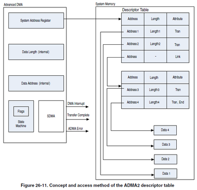

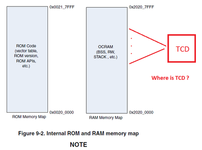

I am stuck with a relationship triangle (LPUART, eDMA, ADMA and OCRAM). I just want to use eDMA with LPUART and trying to monitor my transmit and receive datas on the RAM. Here is my nested path from Reference Manual.
In 6.2 Overview it says:
Local memory containing transfer control descriptors for each of the 32 channels
In 6.2.3 Features it says:

In Figure 9-2. Internal ROM and RAM memory map NOTE it says:
In Figure 26-11. Concept and access method of the ADMA2 descriptor table it says:
So I have following question:
Q1: What is the difference between eDMA and ADMA?
Q2: Where will create my eDMA's TCD in the memory(RAM)? So, Which address interval?

I see that some of your questions have been answered on other threads. I’m adding a link for reference in case it helps other users.
https://community.nxp.com/t5/i-MX-RT/IMXRT1024-LPUART-eDMA-RAM-Location-and-Limitation/m-p/1329191
I think the matter that was not covered would be the differences between eDMA and ADMA. The Advanced DMA (ADMA) is a transfer algorithm used by the SD Host Controller so it’s a different DMA algorithm. There are more details on how it’s handled on the i.MXRT1024 Reference Manual on the uSDHC chapter as it’s main application is being compliant with the uSDHC standard.
