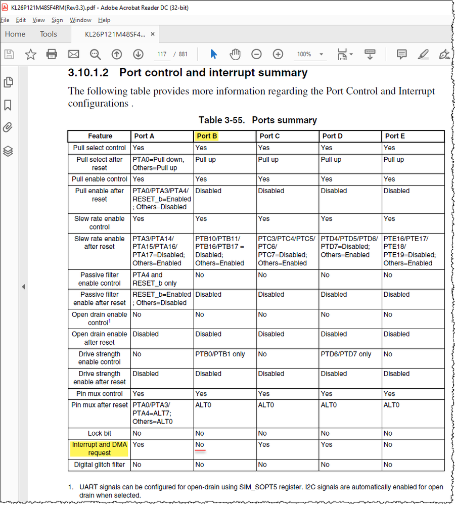

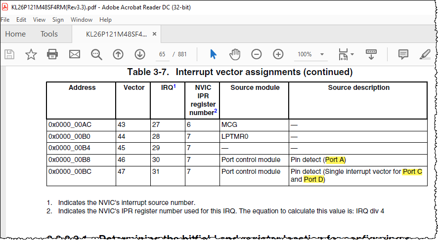

I notice that PORT B has a Interrupt status register(PORTB_ISRFR) and Control register (PORTB_PCR)
Does it have a interrupt vector?
2 返答(返信)
1,783件の閲覧回数
Robin_Shen
Hi d4712,
KL26's PORT B does not support interrupt, so it does not have an interrupt vector either.
3.10.1.2 Port control and interrupt summary.png3.10.1.2 Port control and interrupt summary.pngTable 3-7. Interrupt vector assignments.pngTable 3-7. Interrupt vector assignments.png
