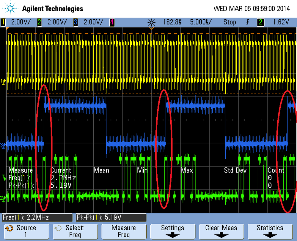

Hi all,
    I am trying to communicate with WM8956 codec over I2S. I2S slave mcu is MK10DX128VLL7. I use processor expert v10.5.1, CodeWorrior 10.5.
WM8956 is I2S master sends TX_BCLK and TX_FS
MK10DX128VLL7 is I2S slave sends TX_Data
Yellow: TX_BCLK
Blue: TX_FS frame sync
Green: TX_data (send from kinetis)

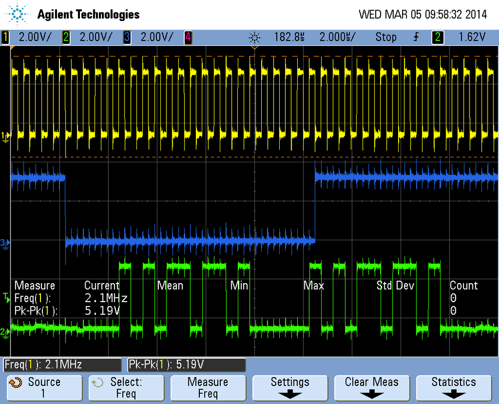

I want to send 16bit data for each left and right channels. You can send 21bit for one channel in my clocking configuration. After frame sync signal is changed, TX_data should be like that first bit is empty next 16bits are data and last 4 bits should be empty. But as you can see from the scopes below highlighted with red circuls, there are changes while 4 last bits.  So I think MCU does not try to sync with Frame Sych signal.

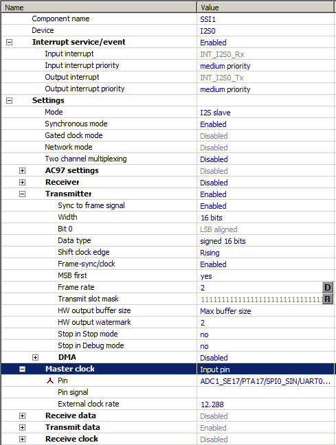

My processor expert properties are also attached. Please give a suggestion...
Thank you...

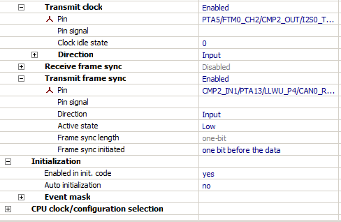

As you have said, the SAI module of K10 works in slave mode, the bit clock and frame clock TX_BCLK and TX_FS are from external device. From the waveform of scope, obviously, the frame clock signal TX_FS is a word clock rather than a bit clock, but in the PE beans, you select "Transmit frame sync"->"Frame sync length" as one-bit clock, it should be "one-word", at least, this is a issue, pls check the SYWD bits in the I2Sx_TCR4 register, it should be 01111 in binary. pls try to change it.
I have counted the clock number the TX_FS covers within High logic, it seems the number is 21 rather than 16, are you sure it is correct?

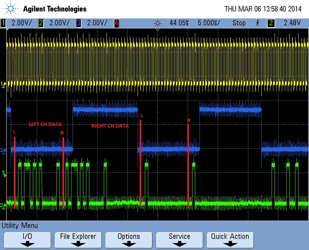

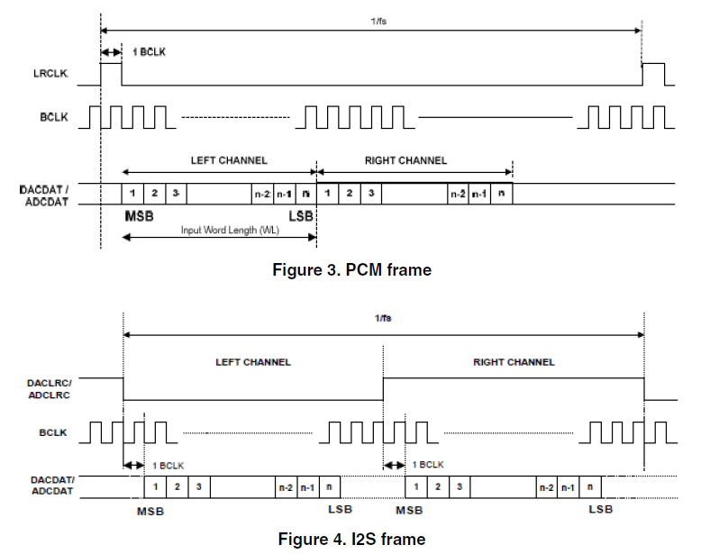

    Hi, now I send same data for left channel and right channel to better understand FS signal and TX_DATA. What I saw is that for right channel SAI does not wait FrameSync signal to go high. It appends right channel data to left channel. AN4800 document explains PCM and I2S signals, you can see a copy below. PE I2S slave TX_data signal looks like PCM data signal.
    I tried to change SYWD bits( from generated code because it is grayed out in PE ) as you suggested and I also tried the values 20,21 but nothing changed.
    Probably I have to use my codec in PCM mode.
figure: AN4800 page3

      I actually solve problem by running WM8596 in PCM mode since K10 send second channel data right after first one. According to I2S protocol second channel data should be send after rising edge of FS. and FS should cover all the data bits but it can be longer than a word. What I mean is that if you want to send 16bits word for a channel FS low time or high time can be greater than 16bits there is no restriction about how much greater. I get this idea from AN4800 page 3 and google search, of course I am not 100 percent sure. Thank you for your help...
