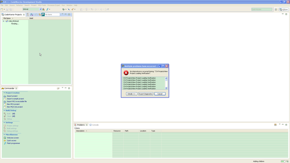

Kan_Li
Hi Anand,
Unfortunately, I can not open the CAN_MODULE by CW 10.5, would you please help to clarify?
