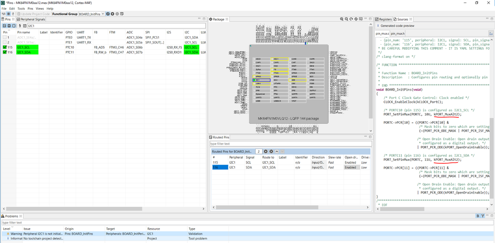

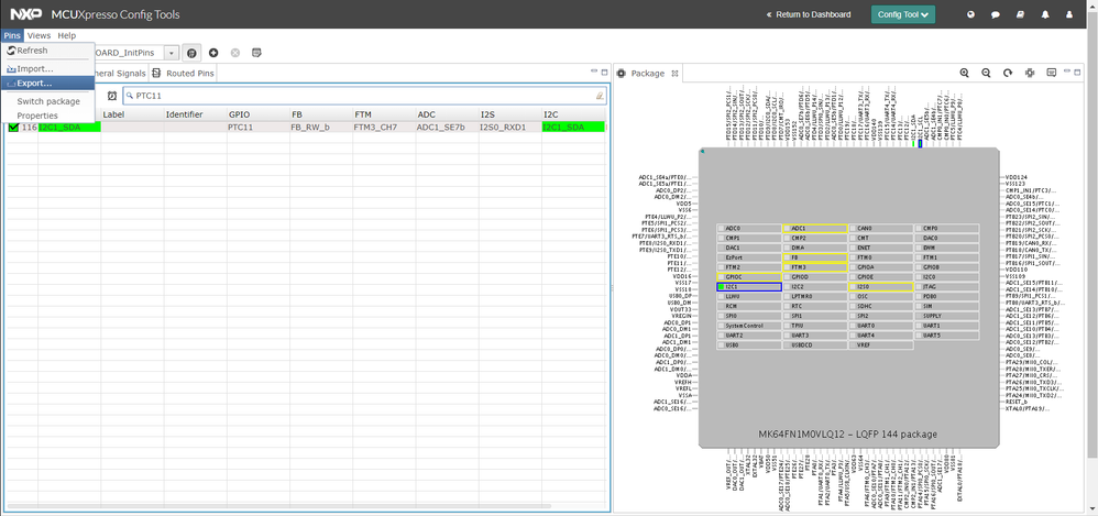

Robin_Shen
Hi david,
Would you please tell us which MCUXpresso Config Tools are you using?
I am using online and offline MCUXpresso Config Tools, both of them can generate correct codes.
PORT_SetPinMux(PORTC, 11U, kPORT_MuxAlt2);
The i2c interrupt in SDK_2.3.0_FRDM-K64F also generate correct codes.
Robin

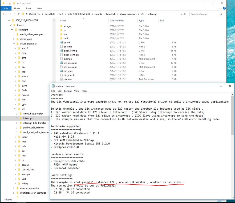

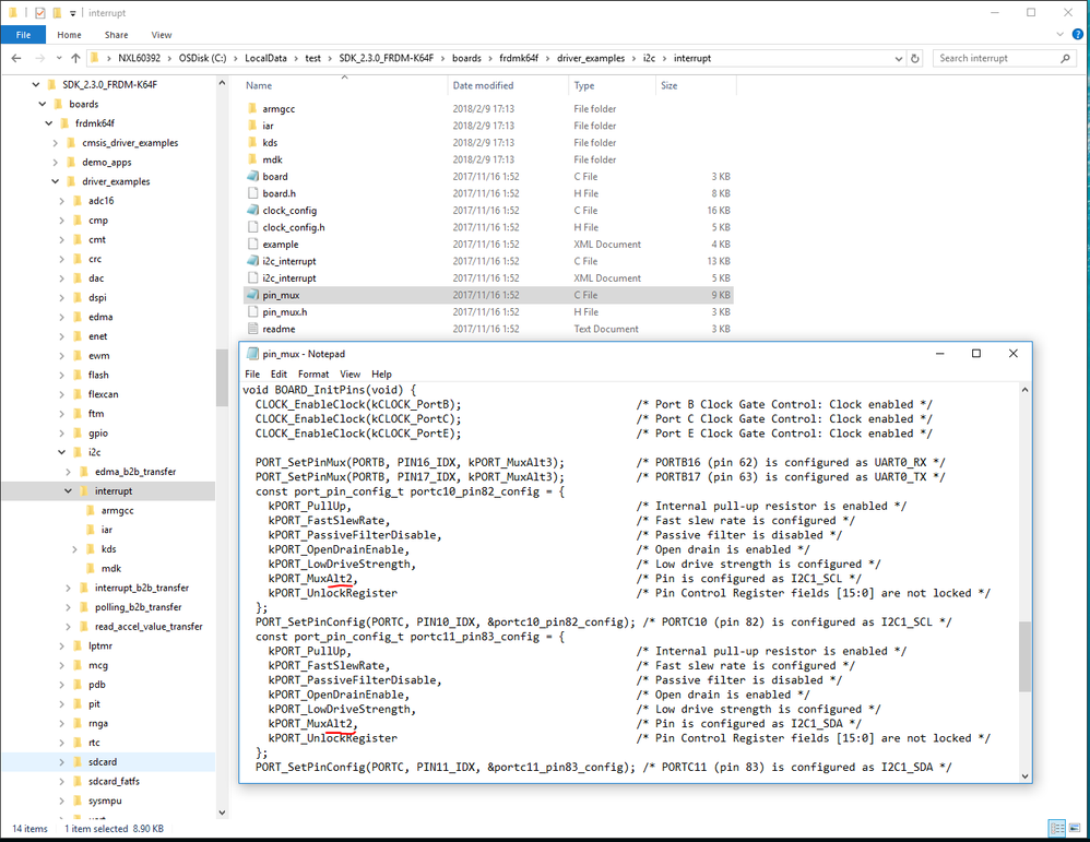

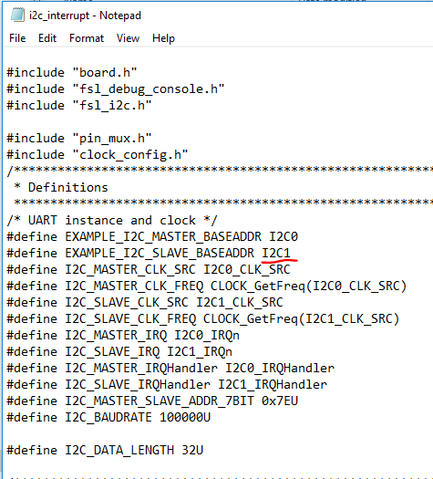

Robin_Shen
Please download the  SDK_2.3.0_FRDM-K64F package refer Generating a downloadable MCUXpresso SDK v.2 package.
And then you can find the i2c interrupt example in it's folder. (For example: C:\SDK_2.3.0_FRDM-K64F\boards\frdmk64f\driver_examples\i2c\interrupt)
The example is configured 2 instances I2C , one as I2C master , another as I2C slave.
Robin

davidatkins
It seems that the PORTC I2C1 pins are configured as muxalt2 not muxalt5, this is from looking at the outptu of the config tool, nto sure which is correct now.
