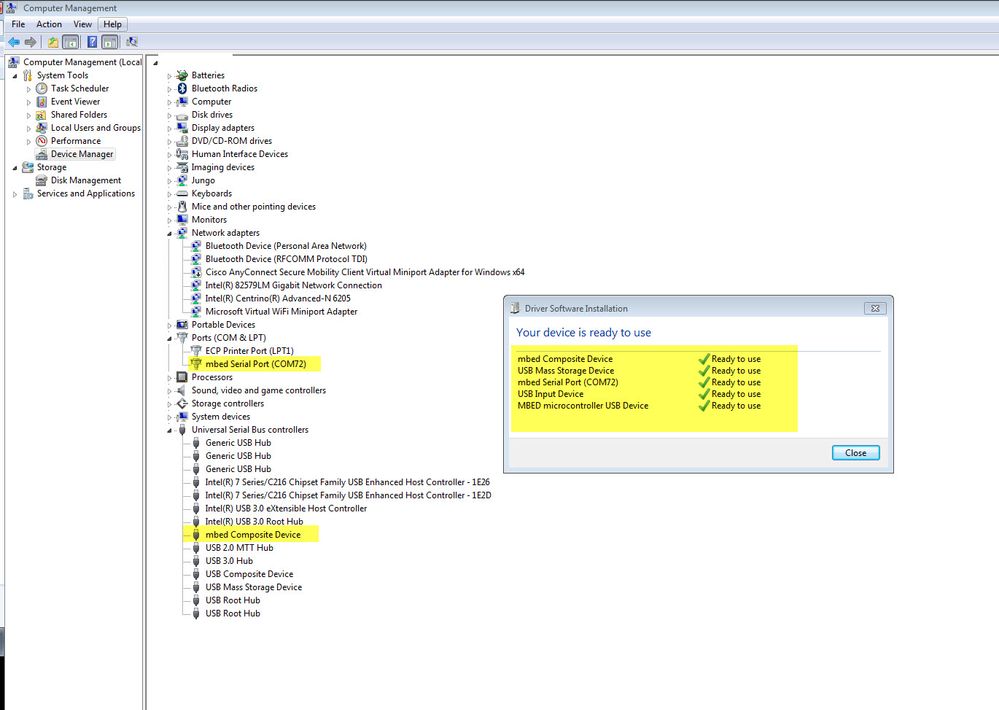

  This is my MAPS-KS22 picture from my PC.
MBED serial port driver:
https://developer.mbed.org/media/downloads/drivers/mbedWinSerial_16466.exe
Actually, you already install it.

If you still have question after you change the firmware with the win7, please give me some picture on your side, device manager, and what the board device name on your side, in bootloader or already in the firmware mode.
