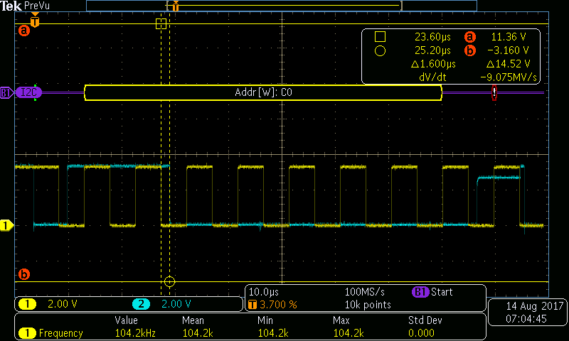

Hi, I am having problem with I2c module, after sending Address byte from MCU the slave is not able to Acknowledge it looks like the Master is not giving line free for slave to acknowledge.
Our scenario:
MCU MK66 (CoreClk180Mhz, Fbus 60Mhz)
IDE Atollic
Slave Mcp4728 (Quad 12Bit DAC)
I2C Baud 100Kbps
Board Custom Board.
Code custom code (parts copied from SDK).
In order to test the Hardware connections I wrote a SoftI2CMaster (using Bitbang) and it works fine only the built-in hardware I2C module makes problems.
Attached please find the Oscilloscope Screen-shots for software and hardware I2CMaster.
Also the code for both.
I have been banging my head since Monday, can anyone please help.

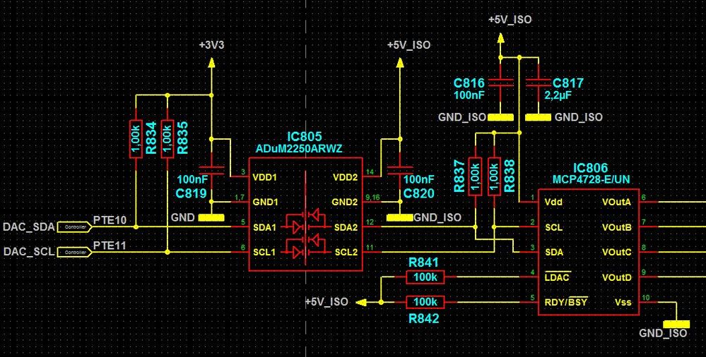

ishwarlal
hi, Update
attached please find the schematic.
I tried to bridge the (IC805)(ADM2250ARWZ) and tried with different Pull-ups 1K to 10K
but no improvement.But in all hardware test conditions the SoftI2CMaster works fine only the
hardware one not.
I am using I2C to achieve 4x Galvanic Isolated Analog-Outputs, but as I said for tests I just removed the Isolation IC.
Lal.

egoodii
Senior Contributor III
Your text says 100K I2C rate, but your scope shots show closer to 375KHz, and more particularly your selected HW I2C settings are giving only something like 0.6us 'data hold' after falling clock edges, whereas SW is giving more like 1us.  "Fast Mode' of MCP4728 calls for 0.9us 'hold time', and I expect your 'galvanic isolation' degrades that timing margin further.
Your slave 'fails to acknowledge' because it 'fails to recognize' the address.

ishwarlal
Hi Earl thanks for your Reply,
Well with the scope shots (I uploaded the wrong ones) sorry for that. Attached please find the Scope shot of 100Kbps and 26Kbps, unfortunately the problem persists. Problem is that I am finding it difficult to set the desired Baud-rate and the required Hold-Times at the same time. Both are interlinked. So I tried a Mul value of 4 and a divider value of 576 (in I2C_F register) which gives 26Kbps baud but no improvement.
HwI2CMaster100Kbps
HwI2CMaster26Kbps
17,713 Views
egoodii
That is certainly both confusing and disappointing.  I agree, the entanglement of 'setup/hold' with 'baud-rate' is certainly 'confusing at best', but it looks like you have certainly tried 'slow enough to make anything happy!'...if 6.8us doesn't work, then we have to assume 'something else'.
I am assuming that 'somewhere to the left' there was either power-up or 'stop' so that we can assume the 'slave' is 'truly idle' coming in.  Otherwise, I've got 'no viable excuse' for NACK...
