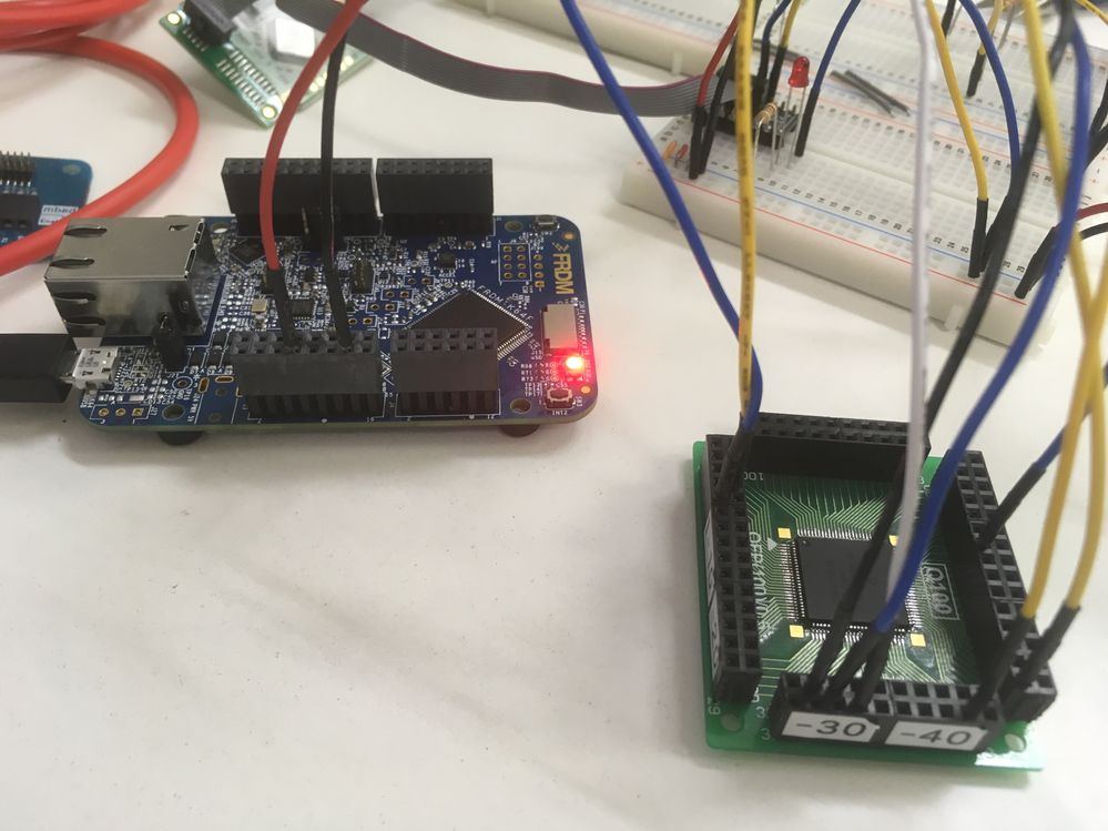

kazukiyamashita
I'm going to create your own board.
Chip who use a FRDM-K64F is the same board for comparison.

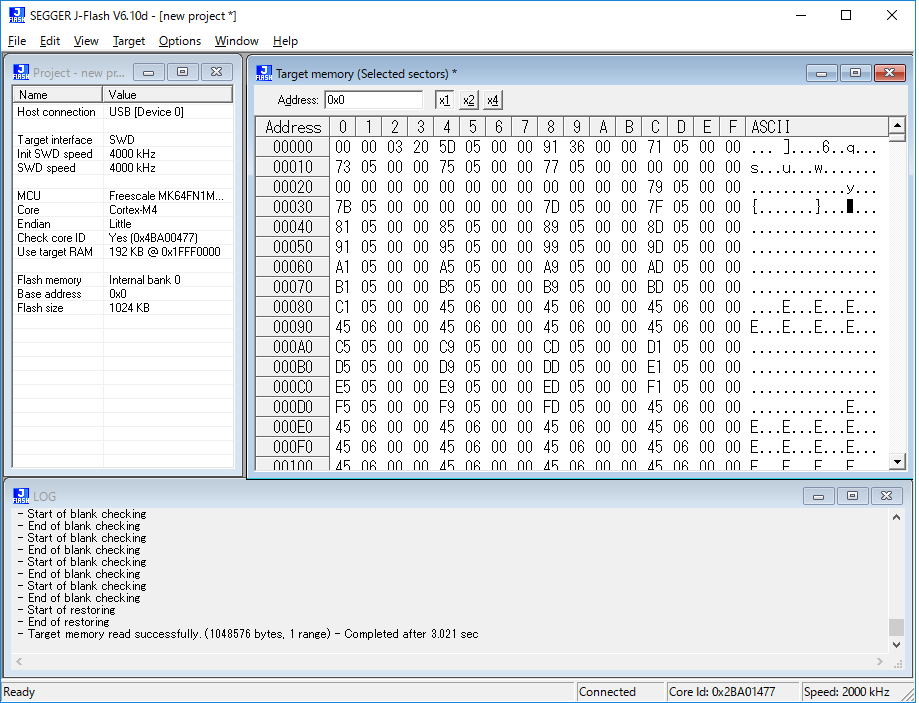

What I've tried are as follows.
Connection in the SWD has take the confirmation.

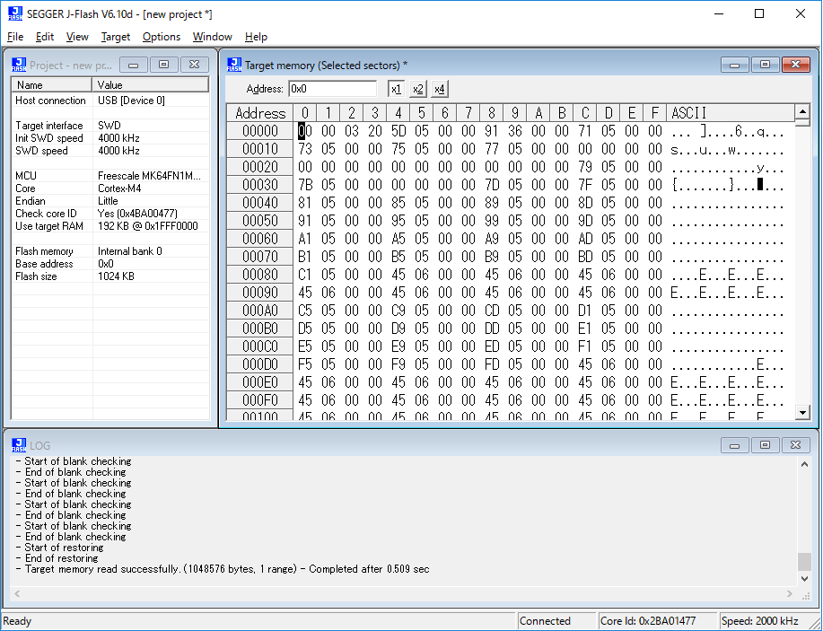

This was confirmed in the following way.
SEGGER J-Flash V6.10d of Target -> intended binary Read back was displayed.
Comparison is reading the same binary written in FRDM-K64F, were compared.
A binary that works with FRDM-K64F, when written in its own board, it has problems that do not work.
If I was to start the custom board in keil debug mode, you can see that the move rare. Procedure at that time was as follows.
Debug -> Start/Stop Debug Session -> Run -> Reset CPU -> Stop -> Run

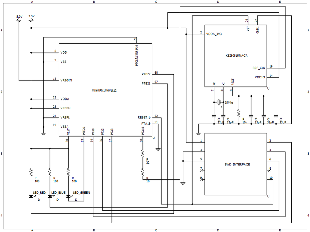

My to create a circuit I believe than there is a problem.
And, Circuit diagram is as follows.

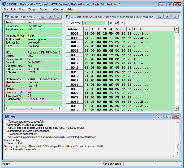

Robin_Shen
If the software is written in swd, the boot loader is unnecessary.
After compiled the mbed_blinky project, I got the mbed_blinky_K64F.bin file.
Writing of program uses the SEGGER J-Flash V4.92.

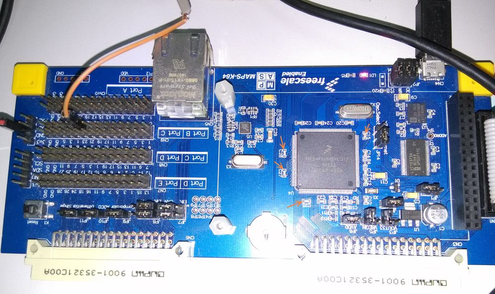

The PTB22 is toggle on my customer board.
Would you please attach the schematic here? So that we can check the circuit whether it has problem or not.
From your image, I can't see any bypass capacitors or resistors.
Supply routing – For Quad Flat Pack (QFP) packages, the power supply pins may be supplied radially to the MCU using traces rather than from planes. While it is adequate to place the bypass capacitors close to the VDD and VSS pins on the traces leading to the MCU, it is better to have the ground side of the bypass capacitor tied to the ground plane (through a via and short trace) close to the VSS pin and the VDD side tied to the power plane (through a via and short trace) close to the VDD pin.
Robin

Please observe the waveform of Reset_b with an oscilloscope. Make sure it high.( not sawtooth wave)
Please confirm the PTA4(NMI_b) is high. If the NMI input is low and the NMI function is enabled in the NMI_DIS field(by default), this results in an NMI interrupt.
The RESET_b pin, if enabled, must have a 100 nF capacitor close to the MCU for transient protection. The NMI_b pin, if enabled, must not have any capacitance connected to it. Each pin, when enabled as their default function, has a weak internal pullup, but an external 4.7 kΩ to 10 kΩ pullup is recommended. As with power pin filtering, it is recommended to minimize the ground loop for the capacitor and the VDD loop for the pullup resistor for these pins.

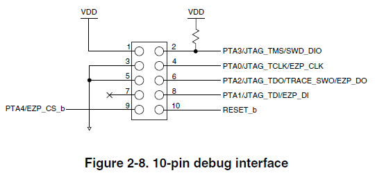

The JTAG_TMS signal on PTA3 requires a strong pullup resistor for mode selection. For the debug interface, you can refer below image:
Do not connect 25MHz quartz crystal unit to RTC oscillator(XTAL32 and EXTAL32).

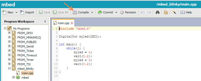

Operation check has been taken in the FRDM-K64F.
Compilation is doing in the online.
Development Platform for Devices | mbed
The following image is a thing of when the LED Blink test was carried out in FRDM-K64F.
Writing of program uses the SEGGER J-Flash V6.10d.
The program was considered to be funny, but it works fine in FRDM-K64F. For this reason, I thought whether the circuit is wrong.
