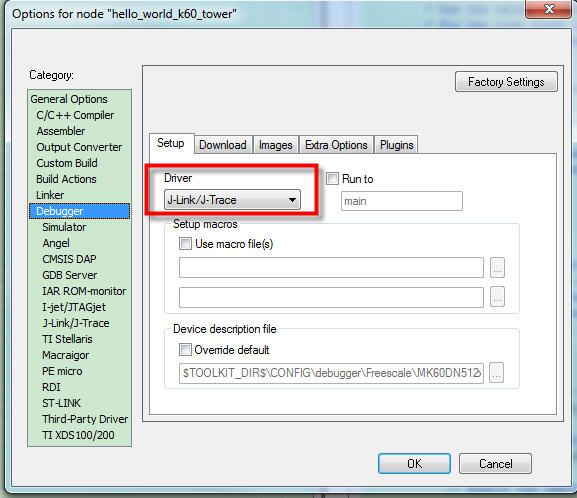

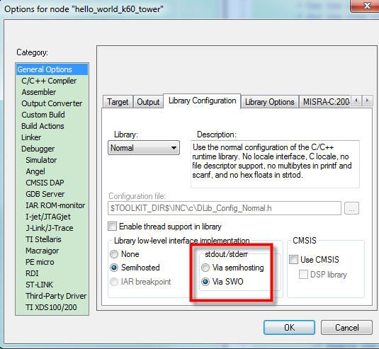

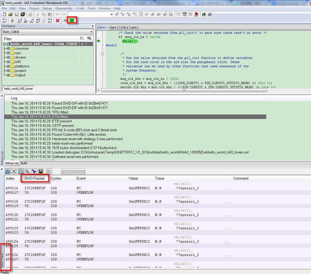

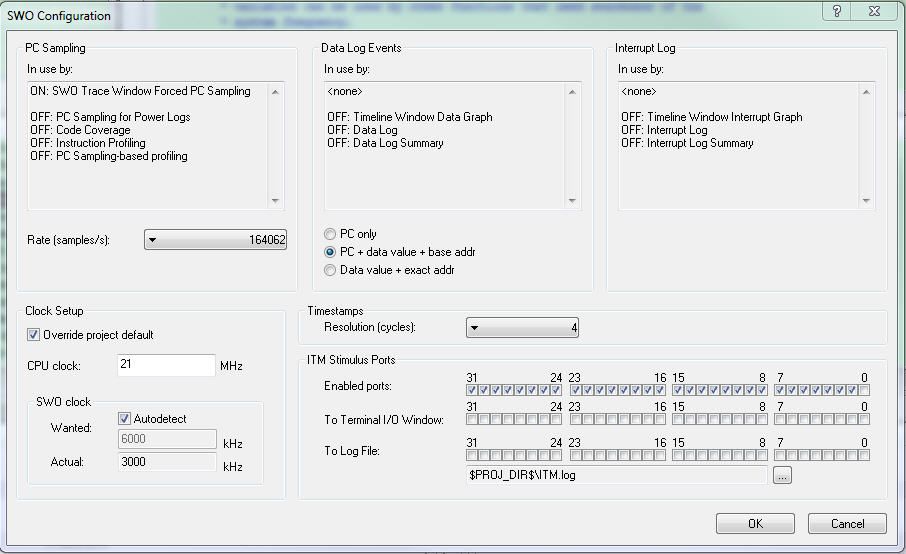

Hi Frank,
I check IAR ARM Workbench support J-Link SWO debug/Trace.
I do a test with IAR software and record my setting with below pictures.
Wish it could be helpful.
with regards,
Ma Hui
Setting with IAR project option:
Debug panel setting:
