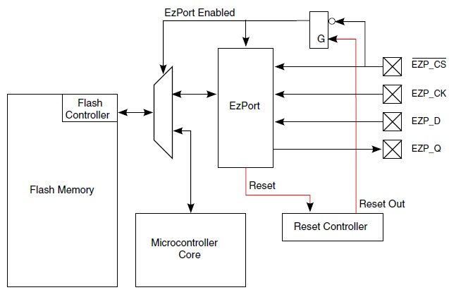

     This document describes how to use ezport module on TWR-K22F120M,  and the usage of ezport on other platforms  is similar.
     The EzPort module is a serial flash programming interface that enables In-System Programming (ISP) of flash memory contents in a 32-bit general-purpose microcontroller.
     The block diagram of EzPort module is as follows:
