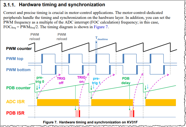

I use frdm-kv31f, the sdk version is 2.10, I want to implement pdb to trigger adc, the example of sdk is not clear.
2,213 Views
Robin_Shen
Hi Alan,
Please refer: AN12374 PMSM Field-Oriented Control on FRDMKV31F with Hall and Encoder Sensors
It may help you understand the relationship between FTM PDB ADC
AN12374SW
Robin
