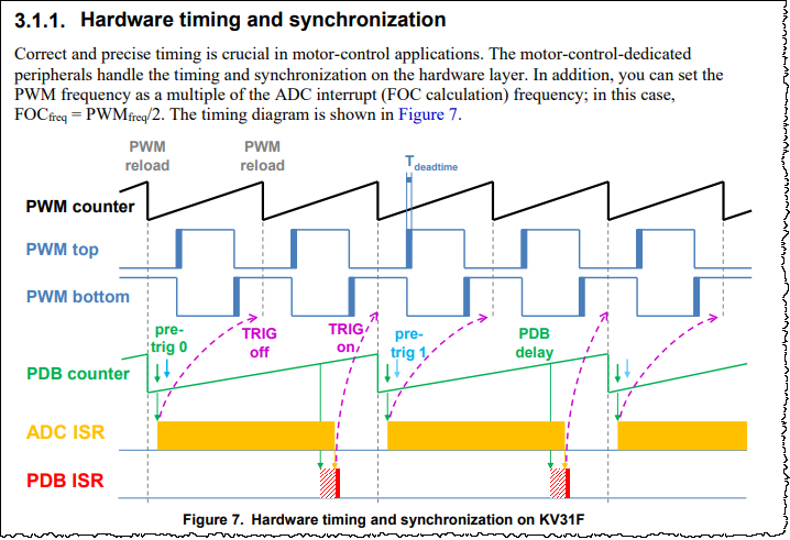

I use frdm-kv31f, the sdk version is 2.10, I want to implement pdb to trigger adc, the example of sdk is not clear.

Hi Alan,
Please refer: AN12374 PMSM Field-Oriented Control on FRDMKV31F with Hall and Encoder Sensors
It may help you understand the relationship between FTM PDB ADC
Hardware timing and synchronization.pngHardware timing and synchronization.png
AN12374SW
Robin

Nice graphic - it's always useful if you can visually show what's happening in the system.
